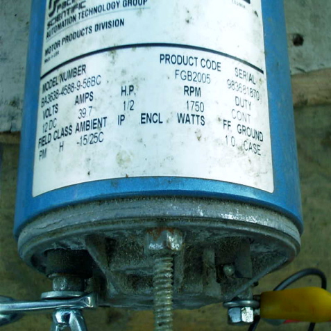

Here are some pics of a home brew electric start 5HP
Taking the Biggs an Stratt to the next level
Had some time to play today  :  )
So I did a quick  lash up of a Briggs powered battery charger with electric start.
The generator / starter is a ½ HP PM motor  the engine is a 5HP
I am using a car solenoid and a key switch to power the motor to start the engine
It spins it over and starts the engine nicely   :  )
I still need to add a blocking diode

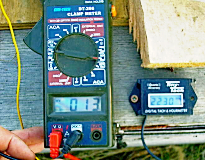

to keep the motor from draining the battery  when the engine is shut off. I am thinking it should be able to put out  25 to 30 amps. But haven't put a load to it yet.
I am waiting for some parts for a simple dump load charge controller
instead of turning on a load when battery is charged .
The relay contacts will be for the engine kill switch .
Then on to the next stage adding a PLC to automate the starting of the  engine based  on battery state of charge. What FUN :  )

I note the nameplate rating on the genny - it is rated for 12vdc @ 1750 rpm.  Even with a 14.4 output for charging batts., your Briggs will be running at only 2100 rpm.  This is far below the speed at which it develops significant power; most small engines are rated @ 3600 rpm.  I suggest a 2:1 vbelt step up instead of your very neat direct drive for a much more satisfying result.    K3CZ

Oh yes I know the motor is to small for the engine but I had it on hand At 3600 rpm I getting around 18 volts.
