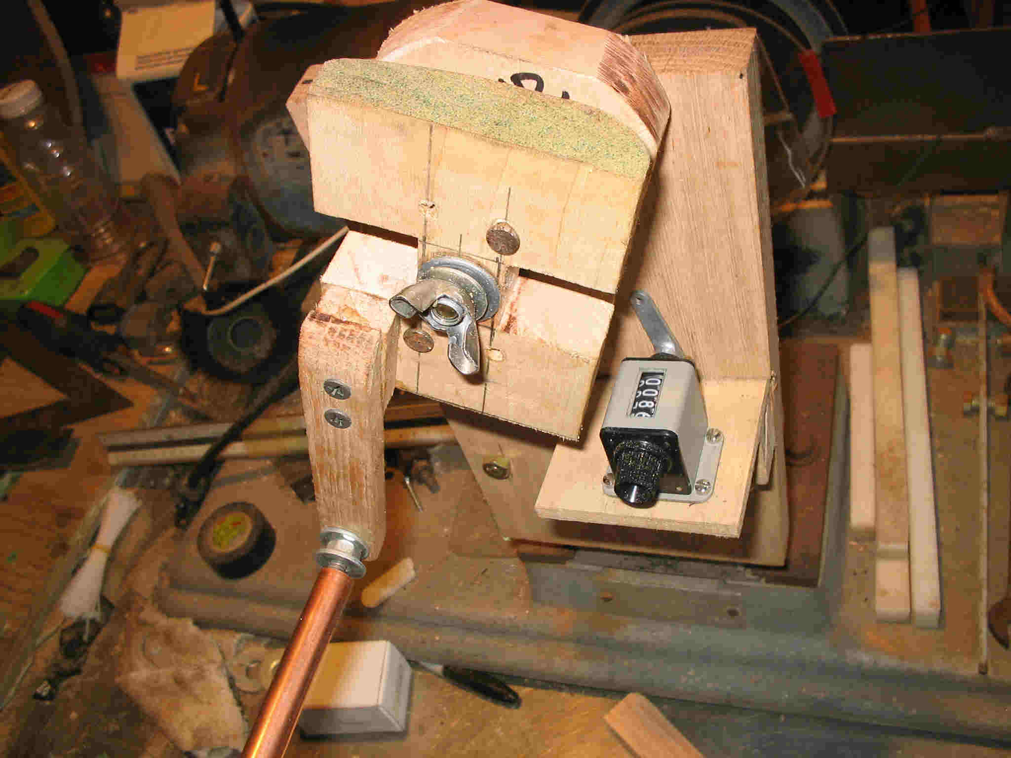

Here's my new coil winder. It's origin is in Hugh's plans from his latest book. I added a small shelf to put a counter on board. The counter was purchased from a John Deere dealer for about 15 bux. 3 of the corners of the back "H" were rounded off so the 4th corner would swipe the counter arm. It allows me to concentrate on getting the coil wound tighter. The coils have turned out a lot smaller with the same # of windings.

 I tried many different sizes & shapes of coils. Just cut 1/2 inch plywood to the size of the hole in the coils that I need and two larger pieces to hold the wire in. Bolt the 3 pieces together. It helps to cut some slits in the larger parts of this jig so you can get some string in there and tie it all together before unbolting it to remove the coil.
 Hand winding coils does not produce a very uniform wind, so I built an electric coil winder. Got an electric motor from an old Disco Spinner Light (15 rpm). Bought a Coupler for Threaded Rod. Drilled the threads halfway out, And epoxied it to the shaft of the motor. Now my plywood Coil Forms screw directly to the shaft of the motor. It's not any faster but it's easier and makes a much better wound coil. No Turn Counter yet, I have painted one edge of the Coil Form red and count it everytime it goes by. I made the coils with 125 turns and it took about 9 minutes each.
Sitting next to the motor in the picture is my jig for holding the coils in the Airgap of my dual rotor machine for testing.
