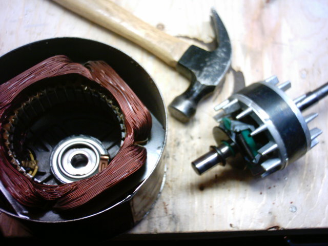

This message has a photo of the induction motor I'm trying to convert. 1/3hp , 120vac, 1725rpm, 36 slots in the stator. It has a start up winding switched by a centrifigal switch thingy. If I had neo magnets on the rotor, would I get usable power from the existing windings , ie: 200-300 rpm into 12 volt battery. How do you get to the indivigual coils if I want to put a bridge rectifier on each phase to add together for more current?

by Jerry on Tue Nov 09, 2004 at 08:49:38 PM MST
Hi Paul
Heres a couple pictures if they work?
This lst one is a solid steel armature. The side walls are 1/4" plexi.

by Jerry on Tue Nov 09, 2004 at 09:23:59 PM MST
OH thanks Tom &Ed.
Several years ago I discovered this site thanks to Richard Perez of the Home Power Mag (thanks Richard).
It was my introduction to ac motor conversion. Back then I started a search for free  ac motors.
My sources were (and still are) plumming shops, heating & airconditioning shops, motor rewind shops ect.
I've collected around 1,000 motors FREE. I've converted many diferant types.
The easyest and most plentyfull and with very good results have been garbage disposal motors.
Reasons why. These motors are designed for intermitant use, short time on.
Also these motors have an unusually large bore for the hp rating. This larger diameter creates fast magnet speed past the coils for higher output.
They are also wound fairly loose. This permits easy seperation of coil wire ends.
Its very easy to seperate all 8 coils. 4 starts & 4 runs. Reason for coil seperation.
These are 120v motors. They have 4 run or main coils. These coils are wired in siries. This means each coil is a 30 volt coil. If we were taliking about a 1 hp motor its is rated at 10 amps. BTW 10 amps X 120v = 1200 watts.
We know each coil is a 10 amp coil. If we perelelled all the run coils the motor would be a 30 volt 40 amp motor. BTW 30v X 40 amps = 1200 watts.
In terms of useing the motor as a PMA 30 volt is closer to 12v and 40 amps is better than 10 amps. Problem is we would need to spin the motor faster than the expected blade rpm to work well as a wind genny. So we do a comprimize and do a siries perelell combination on the coils.
This can also be done on the start windings. Since they are out of phase with the runs they must have there own and seperate fullwave bridge rectifier.
Then end result is a two phase pma. This further reduces rpm requierments.
Most motors are baked in varnish and dificult to work with. Not so garbage disposal motors.
BTW the 1 hp are extreamly rare. There are many 1/2, 1/3, 5/8 and 3/4 hp. the higher the hp the higher the power.
Wind test data on a 1/2HP.
5 mph 2 amps, 10 mph 5 amps, 15 mph 8 amps, 20 mph 12 amps, 25 mph 23 amps, 30 mph 26 amps
A 1/3 hp would be slightly less.

Paul your motor has bushings. To make a successfull genny bearings are a good idea. It will help reduce cogging and last much longer.
If you could find end caps from another motor with bearings or build new end caps of plywood and insert your own bearings. This works very well just weatherize the plywood.
If you could locate some curved NEOs the end result would be surprizing for such a small unit.
If any one is Intrested I will sell garbage disposal stators, cans, uncut armatures and plywood end caps at $10 each plus COD and shipping.  What I'm saying is you get the stator in its motor can two plywood endcaps and a unmodifide armature for $10. I have many. The armatures are from furnace blower motors. They have good shaft lingths the original armatures do not. Also these armatures are of smaller diameter so less maching is requiered.

   Hello. If you are going to convert a motor,try to find one that has 8 start & 8 run windings.You will get much more out of them compared to the kind that has only 4 windings.Some of the older ceiling fans have a lot of copper.The kind that look like a regular fan motor about 4" dia x 6" long. They will put out as much as 50 open volts spun with a drill motor,of course the battery will pull it down to what you need.  I hope this helps.
