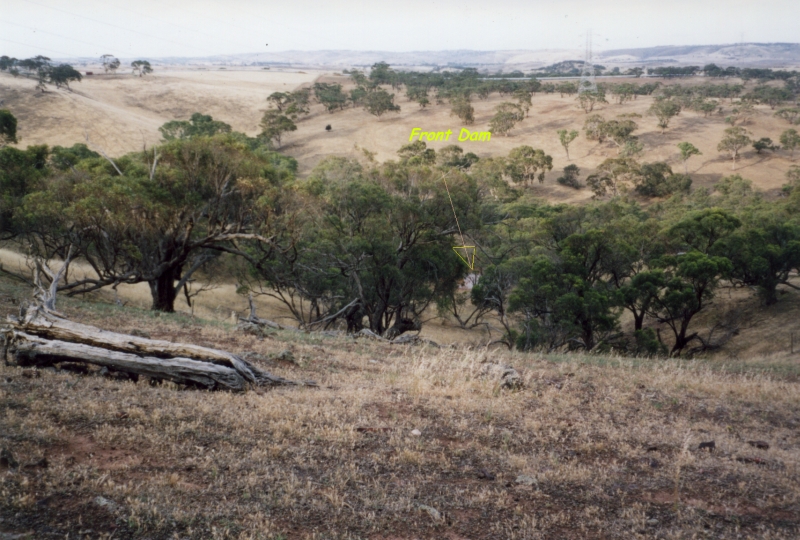

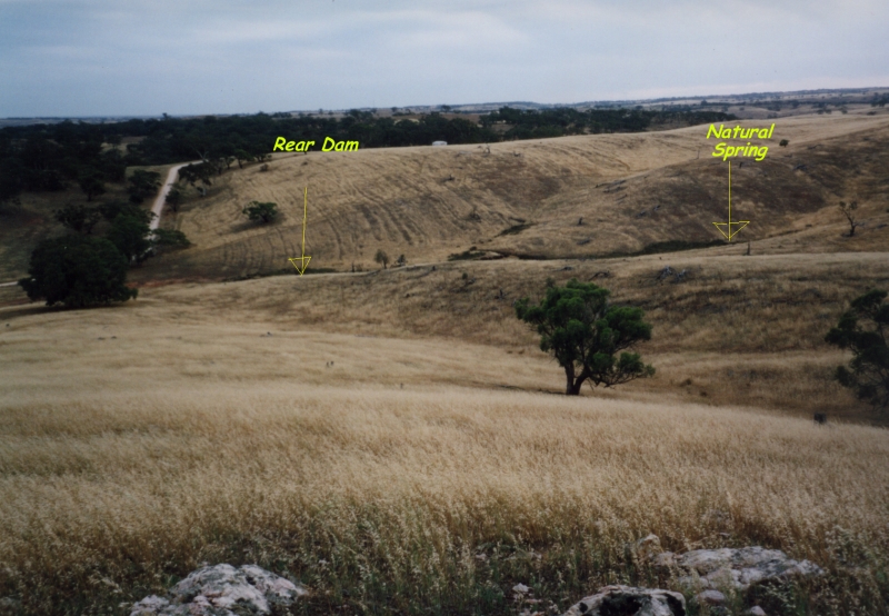

by Bryan1 on Thu Dec 23rd, 2004 at 08:31:14 PM MST
Hi I finally got round to taking some photo's of both sides of the hill, and I added where the main Dams are in 2 of the photo's.
To the right of the front dam just visable is my 12x11 metre shed behind the trees
Just to show perspective the gum tree on the left has a base diameter of about 6 foot

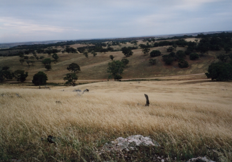

This photo is taken to the left as the 2 rocks can show the angle and the road down the bottom is the rear of my place, this is where I'll be placing the bore as I know theres a good supply of water a 100ft down. As you can see from the photo's it's not a small task I'm undertaking. I plan on placing a 20,000 gallon tank on the top of the hill and a 2,000 gallon tank 1/2 way up the rear part to pump the water in 2 stages. Anyways I hope everyone has a merry Xmas and prosperous new year Cheers Bryan1
