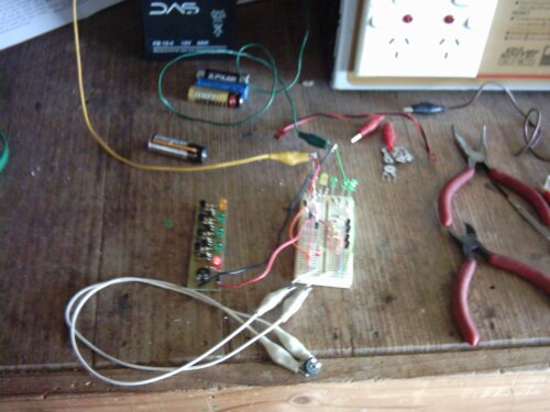

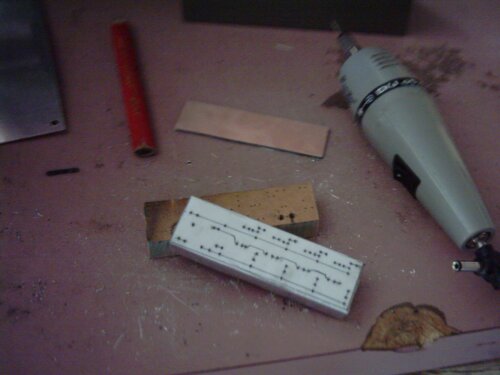

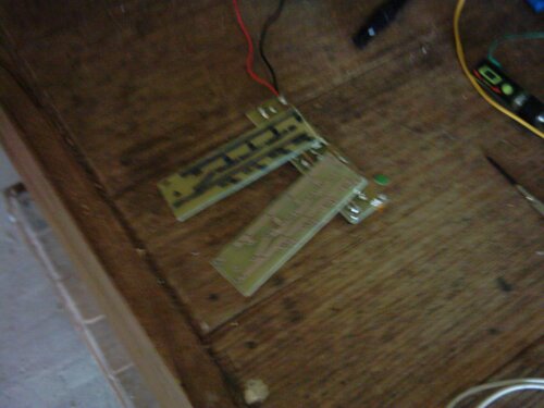

Here's a picture of the finished product, and the prototype on its breadboard:
My initial PCB designs, made using a piece of cardboard and a pin:

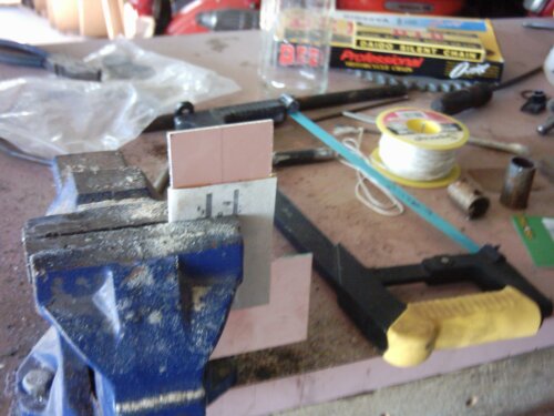

Cutting the blanks out to size - be sure to use a 32tpi blade in your hacksaw!

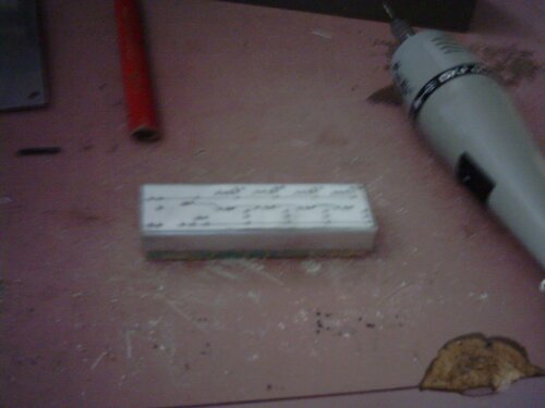

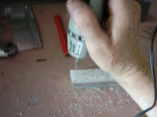

Sicne I'll be making lots of these, I made a drill jig.  It's basically a little aluminium box with the pinout holes in the lid, and a block of wood the same size as the blank.

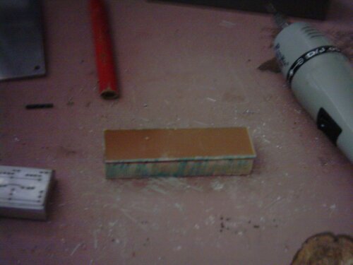

Blank goes on the block:
Jig goes on the blank:
Let's drill some holes!

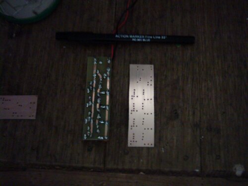

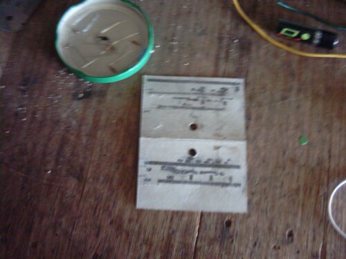

A finished board on the left, and the drilled blank on the right.

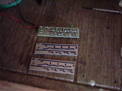

The lands are drawn in place using a special "resist pen" - this is why I decided to go against tradition and drill the blanks first (it makes everything easier to align).

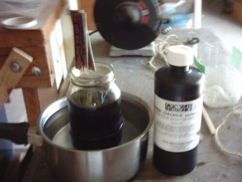

Tie a piece of nylon fishing line through some convenient holes, and dunk the blanks into the warm Ferric Chloride solution for 15 minutes.
This eats away the copper that wasn't covered with resist ink.  I've cleaned up the one on the right with steel wool.
