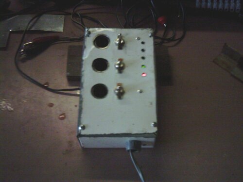

This is the prototype of a small switchboard/distribution box for remote solar lighting systems.  I've tried to keep the design simple and cheap (under $10 Australian for the parts), and hopefully rugged enough to last at least 10 years.
Essentially, it's a box with three switched cigarette lighter sockets, an LED voltmeter, and two pairs of connection for a solar panel and a battery:
Here's a view with a battery connected:

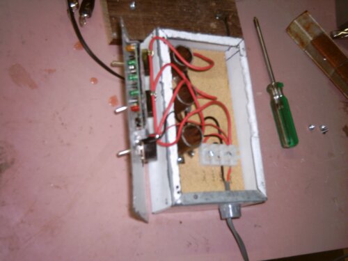

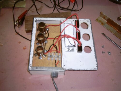

The cigarette lighter sockets are made from short sections of 21mm I.D. tube (in this case, rusty old steel stuff that I had lying around).  The central electrode is a self-tapping screw into the wooden base board, which seems to work just fine.
An oblique view, showing how the voltmeter circuit board is mounted using a couple of layers of double-sided tape:
The fusing consists of a 3AG fuseholder conected at the +ve battery terminal, with a 10A fuse inside.
I knocked this together in a few hours on Saturday afternoon, then took it along to my family pre-christmas gathering for comments.  The recommendations were:
  • (Dad, farmer) Make the cigarette lighter sockets out of copper plumbing tube, as it'll be easier to work, easier to solder to, and more resistant to corrosion;
  • (Tim, brother, electrician) Make the case out of either aluminium or galvanised steel, rather than the bit of old washing machine cabinet used for the prototype;
  • (Dave, brother-in-law, builder of BIG electrical switchboards) Lacquer the voltmeter circuit boards, to protect them from corrosion.

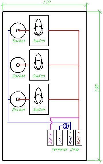

Here's a wiring diagram for the power box (I really should get myself a better camera):

Looks like an interesting project. I do have a few questions and comments. Why the switches? Couldn't you just pull the cig. lighter plug out? Make the sockets a little deeper so they would hold the plugs without making connection until the plug is pushed all the way in? You might also want to look at simply mounting everything on a piece of rot-resisant wood and use solid copper wire mounted securely on the board for connections. Look to antique electrical stuff for examples of how to make circuits that will last.
I thought about that, but since I don't have any control over the quality of the cigarette lighter plugs I thought it was best to design it so that you didn't have to keep unplugging and replugging them.  I also assumed that since every household power outlet in Australia is switched, it must be for a good reason. ;-)
That's a good idea.  I still want to have everything inside a box, but I doubt that the piece of chipboard I used for the prototype would last long in a high-humidity tropical setting.  Perhaps marine ply?
Just my .02
That's all I can ask for. ;-)
BTH
