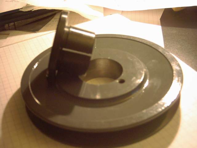

They stock a neat range of pulleys, where the pulley and hub are sold as two seperate pieces. The pulleys are cast iron and have a tapered hole in the centre. The hubs have the shaft size you need with a keyway on the inside, and a taper on the outside.
The hub goes into the pulley and the taper squeezes the whole thing onto the motor shaft - much tighter and more secure than a set screw.
I just got a 6" pulley and 7 / 8 ths hub for less than $15 there. Plus if you find the pulley is not the ideal diameter you can just get another pulley and use it on the same hub.

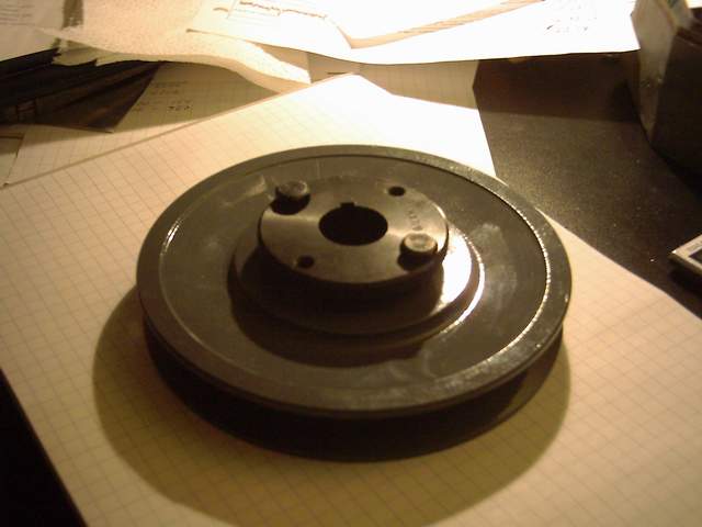

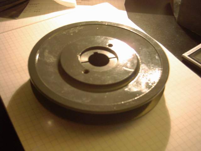

Since the digital cam is sitting here anyway I took a few pics of the pulley type I was talking about:
This pic you can see the hub sitting on the pulley. The hub is split like a collet, it is tapered and gets squeezed in a taper in the pulley.
The hub gets held into the pulley by 2 bolts:
And from the other side, when the bolts are tight the hub sticks out a small (a couple of thou) There are some threaded holes in the hub for taking the assembly off the shaft.
