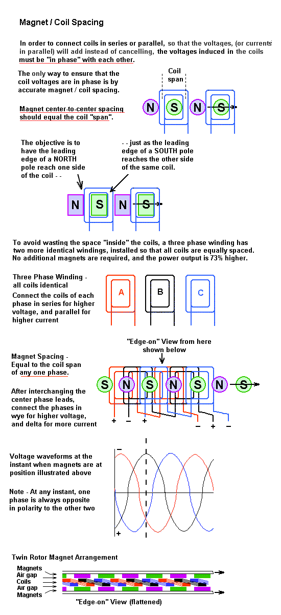

ive been google searching the board alot lately. i'm trying to understand some of the criteria that govern induction.am i right in thinking, the more poles the better , the heavyer gauge copper the better, voltage is only induce in conductors at 90 degres to the angle of rotation.                 here is my question at what point is the electron flow actualy induced.?? that is to say , at the point were the mag. fields intersect . or is it when the coils are over both fields. my understanding is that no voltage is induced while the coil is over one mag. field.

These sketches may help with the basics.
The induced voltage is directly proportional to the number of magnetic flux lines cut per unit of time. 100,000,000 lines cut per second = 1 volt.
Factors affecting this are -
  • Strength of the magnetic flux.
  • Total length of conductor acted on by the flux.
  • Speed of relative motion between flux and conductor.
  • Angle of cutting of flux.
EE

Re: criteria for inducing voltage (3.00 / 0) (#3)
by Electric Ed on Sun Dec 26th, 2004 at 12:57:17 PM MST
Hi Jess,
Everything you said is true, except - "It would essencially be DC".
It would still be AC, but a lower voltage.
EE

to clarify that a bit, it's the change in magnetic field that matters, in combination with the pole of the magnet. Those two multiply to determine the 'quadrant' that you're working in. The other 'leg' with the other pole above it is wound the other way around, and has a magnet of opposite polarity above it.
You could easily make an alternator with only 'N' side up (just leave out the south facing ones) and you'd find you have perfect AC. You could even remove half the 'legs', or all of them but one, it would still be AC.
tricky stuff !
Kudos to Ed, those are awesome drawings ! I don't think I've seen it explained any better, even in physics books.
