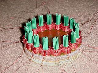

Small axial generator with wire cores.
This is a continuation of a previous posting http://www.fieldlines.com/story/2004/2/1/0449/36712 where I build on the idea of using a core made from steel wire. The stator is built for a single 4.5" diameter magnet rotor. There are 16 small Neo magnets that are 0.5" diameter, 0.125" thick. The idea was to make a stator with 16 coils to maximize the cogging effects. This way it would be easy to tell the effects of the steel wire cores as I changed their shape.

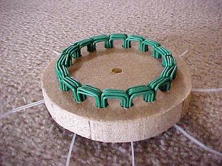

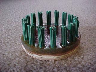

The first picture shows the particleboard form used to hold the U-shaped pieces of steel wire. The wire used was plastic coated gardeners wire. Not the best to use for a full size stator, but fine for these tests. The core diameters are 0.375" and 14 wires would fit nicely into each hole. I used zip-ties to hold the wires on the opposite side.

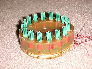

A 4.5" diameter piece of plywood was used as a base and fiberglass resin poured. The previous form holding the wires was then inverted and placed into the resin. This holds the wire cores in place as the resin cures. Then I removed the particleboard form and it is ready for the next step.

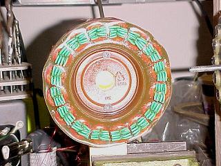

Sixteen coils were then wound from #28 AWG magnet wire. There are 265 turns per coil. The coils were then placed over the cores. I cheated and used hot glue to hold the windings in place as I removed them from the winding form.
Again fiberglass resin was used to encapsulate the coils. All the wires were dressed out the back so I could easily change the wiring. Looks kind of like a birthday cake!

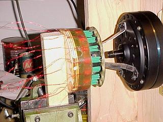

I use a motor from a ceiling fan to turn the magnet rotor. This motor runs at 480 RPM with no load. This picture is with the wire cores un-cut and coming straight out of the coils. This set up yielded an open circuit voltage of 20 with all 16 coils wired in series (480 RPM). Cogging, as expected, was quite severe. I use an X-Y axis drill press vise to hold the stator so I can change the alignment and spacing.
By the way, it might be fun to use a ceiling fan motor as the basis for a generator for those interested in motor conversions.

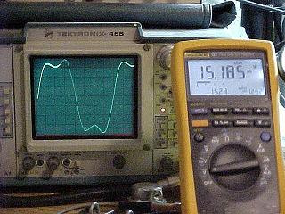

Next I folded the ends of the wire cores over to form a "T". This made it possible to form the slots I was after. Once again the output was 20 volts open circuit. Cogging now was very mild by comparison. If fact, there are now 32 cogging points instead of the original 16. When the motor is stopped, the magnets will come to rest right over a coil, or in between two coils.
Since I used very small wire (28AWG), the output was only 1.2 Watts at 465 RPM. Total series coil resistance was a whopping 24 Ohms. It probably would have been better to shoot for a lower voltage and use 20 AWG wire even for this small generator.
One drawback of folding the core wires over is distortion on the waveform as shown in the picture above. It makes it look like a couple of coils were out of phase, but this is not the case. For those interested the vertical resolution was set to 5V per division, horizontal 2mS per division.
I think if had used varnished smaller diameter steel wire (to pack more steel into the core) and larger coil wire, the output may have been able to get up to 5 watts or so. I'm not sure how much power can be had from 16 small neodymium magnets. Not too sure what I proved here, other than it can be done and it does work...
-Bill-

Hi Bill
Well that's the first really original design I have seen in a long long time. Congratulations on breaking into the cored stator arena with a new concept generator, your on to something here! After looking at your design and specs I noticed a couple of things that you could do to pick up that output.
  1.     You say that you bend the core pieces 90 deg, and left a short leg.. Cut it off straight with the top of your coil. Get it as close to the coil as possible, reduce your air gap! Get rid of the bent leg.
  2.     With the amount of wire you have (in the coil) the output voltage should be much much higher! You have cancellation effects occurring. Start with a single coil and a voltmeter, read the output value, then connect another coil in series, is the voltage higher or lower? Then proceed to go through each one like this in series.
  3.     It appears that your reading the voltage as AC, what you want to do is forget the scope and ac output, its distorted and will be... Hookup the output to a full wave bridge rectifier with a 100uf 50vdc or so capacitor after the rectifier on the DC side.. This will give you your true output potential.
Hope to see some more interesting results and data. " your on the right track!", keep it up!

Thank-you for your comments,
The magnets I am using are 1/2" diameter, 1/8" thick (Wonder Magnet Item # 0032).
I have wound numerous coils for this rotor from 60 turns to over 400 turns and the voltage at 260 turns runs at about 1.25V per coil at around 460 RPM.
The wave distortion appears on all 16 coils when viewed on a scope one at a time. So I don't think it is a phasing or cancellation issue with the series wiring.
I use AC RMS measurements and the scope to better see and understand what is going on. By using a full wave bridge and capacitive filter, the rectified output will be approx. 1.414 X the AC RMS voltage under a no load condition. This voltage would be misleading unless under a load. Then too you have the voltage drop across the bridge itself. For me it is better to measure the AC components during testing.
-Bill-

I suspect that the flattening of the wave for is due to magnetic saturation of the Iron wire cores. This is similar to what happens with square waves in a transformer.
I think this could be improved with a different kind of wire, perhaps a silicon steal composit.
Otherwise a very interisting experiment.
Dr.D
Carpe Vigor, Dr.D
Re: Wire Core Stator Experiment (none / 0) (#7)
by bill541 on Mon Feb 23, 2004 at 05:28:13 PM MST
Now that I think about it, the flattening of the peaks is right when the magnet is centered over the coil. I think what is happening is that the flux through the core is weaker due to the folded wire intersection at the very center of the coil. Pointing the wires straight at the magnet will probably fix the wave form.
I guess the choice is, do we want more cogging or more voltage at the peaks?
Perhaps a stator with 2 times the number of oval shaped coils that fit the same area would be a better approach to solve both issues. If we divide the cogging positions up enough, maybe they will go away! Ha! Ha!
-Bill-

   I noted the small induction motor you're using (ceiling fans use induction motors, don't they?) - does it run slower than its unloaded rpm with your alternator connected? If so, did the different configurations make a difference? Does an electrical load on the output make a difference?
   I'm curious to know how efficient your machine is, and I was wondering if it would be possible to calculate the mechanical power input from the "slip" of the inducton motor. This might not be feasible, I'm no expert on induction motors!
   If there are differences in rpm I would imagine they would at least give an indication of the relative efficiency of each design.

The little fan motor does run a bit faster without a stator in place when the fan motor is set to low speed. On high, there is little change.
When the core wires were pointed straight at the magnets (cogging severe), I could stall the motor out on low speed by shorting the stator windings.
After bending the core wires over to form a "T" and slots (minor cogging), I could no longer stall the motor at any speed.
