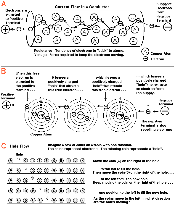

[quote]"Does DC current travel from negitive to positive?"
Yes, current, which is defined as a flow of free electrons from one atom to another along a conducing path, does flow from - to + in the external circuit.
The automotive and electronics textbooks still refer to "conventional" or "hole" flow, and that is considered to flow from + to -.
Electric Ed

Re: Loring Engeneering's Desulfator (none / 0) (#4)
by Radomike on Mon Feb 23rd, 2004 at 09:28:17 PM MST
Electric Ed
  Thanks much for the pictures--now I've got my head around the e-flow idea; words only go so far.
