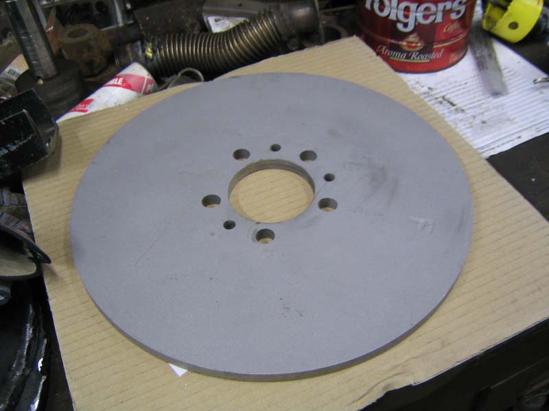

and I ran into a problem. I hopefully took care of the problem. Here is what I finished up this weekend. These are 14" rotors to be used in my new 16' diameter prop 24V machine. These use the same magnets DanB used in his 14' machine not too long ago. I am using .5" steel for the rotors. I cut them out of a sheet of steel and weld them together. I then drill out the center hole and all lug holes. The front rotor gets three additional holes threaded for the jacking bolts used to raise and lower the front rotor. Here is how the discs look after I clean them up on the lathe and sandblast them.
This is how it looks after its sandblasted. I think sandblasting the rotors prior to gluing, helps the glue stick better to the steel. Here you can also see the jacking bolt holes. I drilled and tapped these for 7/16" bolts. I think its adequate for raising the rotors. The magnets are very strong.

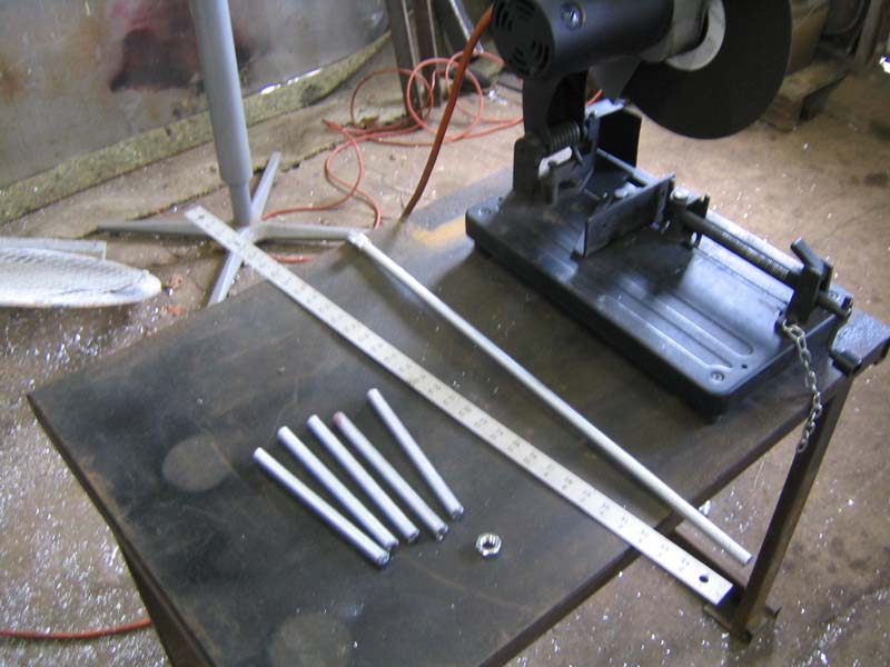

Here is the lugs I cut out of 5/8" allthread. I made them 8" long just to be sure because I am using thicker steel rotors than Dan used. Volvo hubs come in two sizes. The newer cars come with 1/2" lugs and the older ones with 5/8". I like the 5/8" because I feel its alot more sturdy and when it comes time for the hub assembly, its an easy job to drill out the 1/2" hub to 5/8".

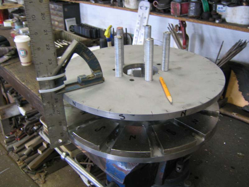

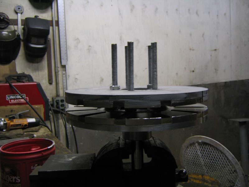

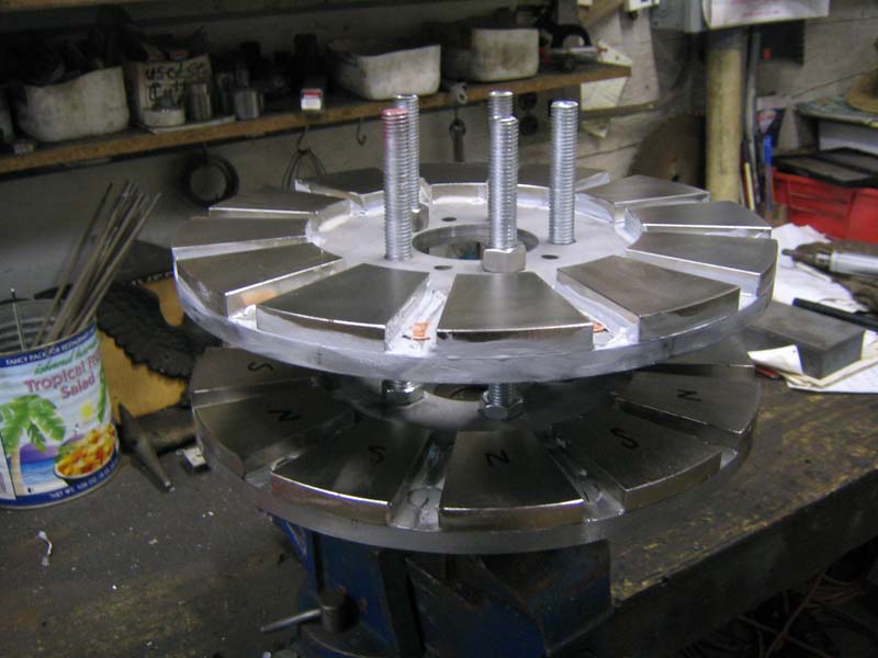

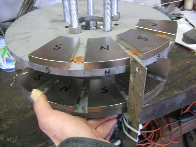

Here is how I align my magnets. I take an aluminum ruler to substitute the steel one usually found in the square because it wont be attracted to the magnets and I wont be fighting it to get a measurement. :-) I basically glue all the magnets on the back rotor and then assemble the front rotor facing up and just transfer the alignment over to the front rotor. I make a pencil mark and then use a transfer punch to mark it on the outside edge. The marks and surface are cleaned off prior to gluing with acetone. After the magnets are placed roughly, I go around and use spacers between each magnet to make sure I have them all spaced evenly.
another shot of the alignment process.

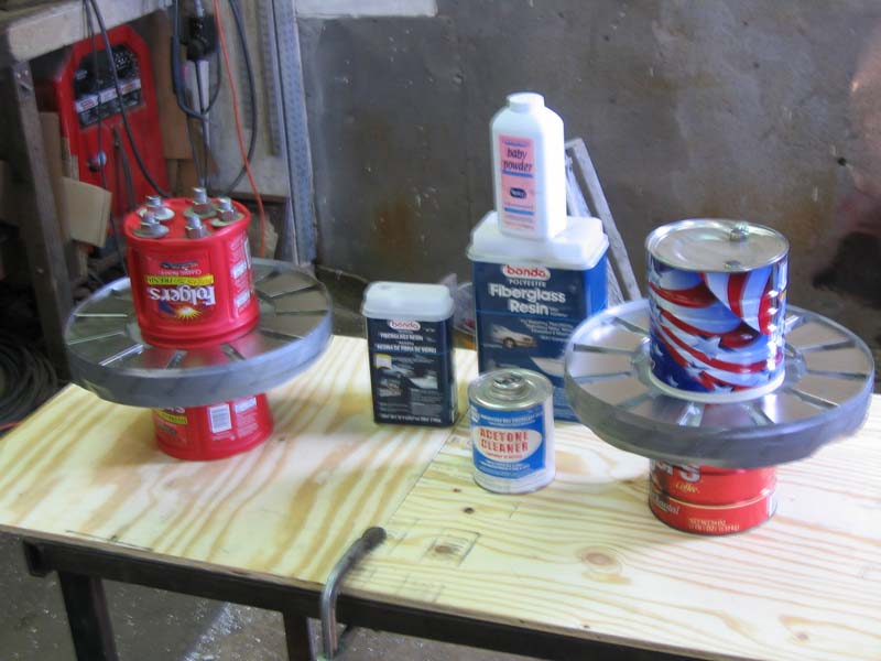

Here, both rotors are ready for casting. All magnets, front and rear are aligned and glued. Again, all exposed surfaces are cleaned and scrubbed with acetone to remove any oils and to make it easy for the resin to stick. These magnets needed to be cleaned very good prior to gluing because I think there was some sort of residue from the plating process left on them. Not a big deal.

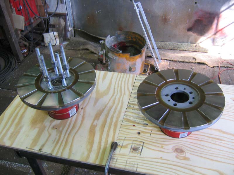

Here both rotors are cleaned and ready for resin casting. I used coffee cans to form the interior dam. It makes for a quick and easy pour. I bolted them down with the lug bolts and jacking screws to make a water tight seal so the resin would not leak out. I use duct tape on the outer edge as a dam. Resin is then mixed up and poured between the magnets.
Here is how they look after the resin cures. The coffee cans make for a very clean edge. Use the plastic cans because they can be bent in and removed easily.

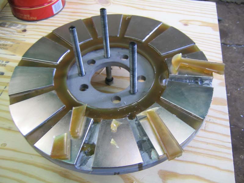

This is what happens when you cure the resin too fast. It breaks when the temperature changes. If you try this, make sure you mix for a slow cure time (25-30 mins). This allows the resin to not cure so brittle. It was easy to fix this. I broke out the cracked pieces, cleaned it well, applied crazy glue to everything (this made me feel better hehe) and mixed up more resin (slower cure time of course) and repoured. hopefully this will not be a problem in the future, but time will tell.

Thanks Dan. Its not feeling like spring here yet hahaha  (here in Long Island, NY)  but hopefully soon :-P  Im thinking Im gonna try to fit 50 turns of 14AWG (2 strands)and see how much room it takes up. Maybe i can fit 12AWG. Im not quite sure yet. Ill have to wait and see. I hopefully should get around to playing with coils within the next day or two.  :-)  Have you ever had resin crack on you like that??.. it was strange.  Have fun with all the spring time projects!!

Mine is 24 windings of 4 strands of #14 (like #9) - its for 12 volts.  And.. it stalled, and I had to open up the airgap, which makes me think that the same forumala could be used for a slightly larger prop.
Ive never had resin crack like that.. mine setup kind of slow.  When I did mine though, I didn't mix any talc or anything with the resin, and it shrank slightly, although it did not appear to seperate from the metal or the magnets anywhere.

That's going to be a pretty serious machine. Maybe a strange question but, why fill in with resin on the rotors ? Seems like alot of additional weight and fuss. Peace of mind ? I can't believe with epoxy glue holding magnets of that size to begin with that they can go anywhere, maybe I'm wrong. Dave B.
Re: new 14 inch rotors finished (none / 0) (#5)
by electronbaby (roy<at>windsine.org) on Mon Mar 22nd, 2004 at 11:31:02 AM MST
Dave, its really for peace of mind i guess :-P  They are glued down pretty good, I just didnt want to take any chances, and this is how Ive always done my rotors, even with smaller (disc)magnets. These magnets are huge and expensive and I jut didnt want to run the risk of them vibrating loose. I am however concerned with the expansion and shrinkage of the steel rotor. Maybe since Ive used such a thick disc, it is more prone to expansion or shrinkage due to temperature(I doubt this) but I have been thinking about it. I like to think it cracked because my resin cured too fast, but like I said, time will tell. I cant wait to get started on the coils and have some real data for you guys. A machine this large is a really fun project. :-)

Have you tried epoxy? You can get slow hardeners that take hours to cure.
