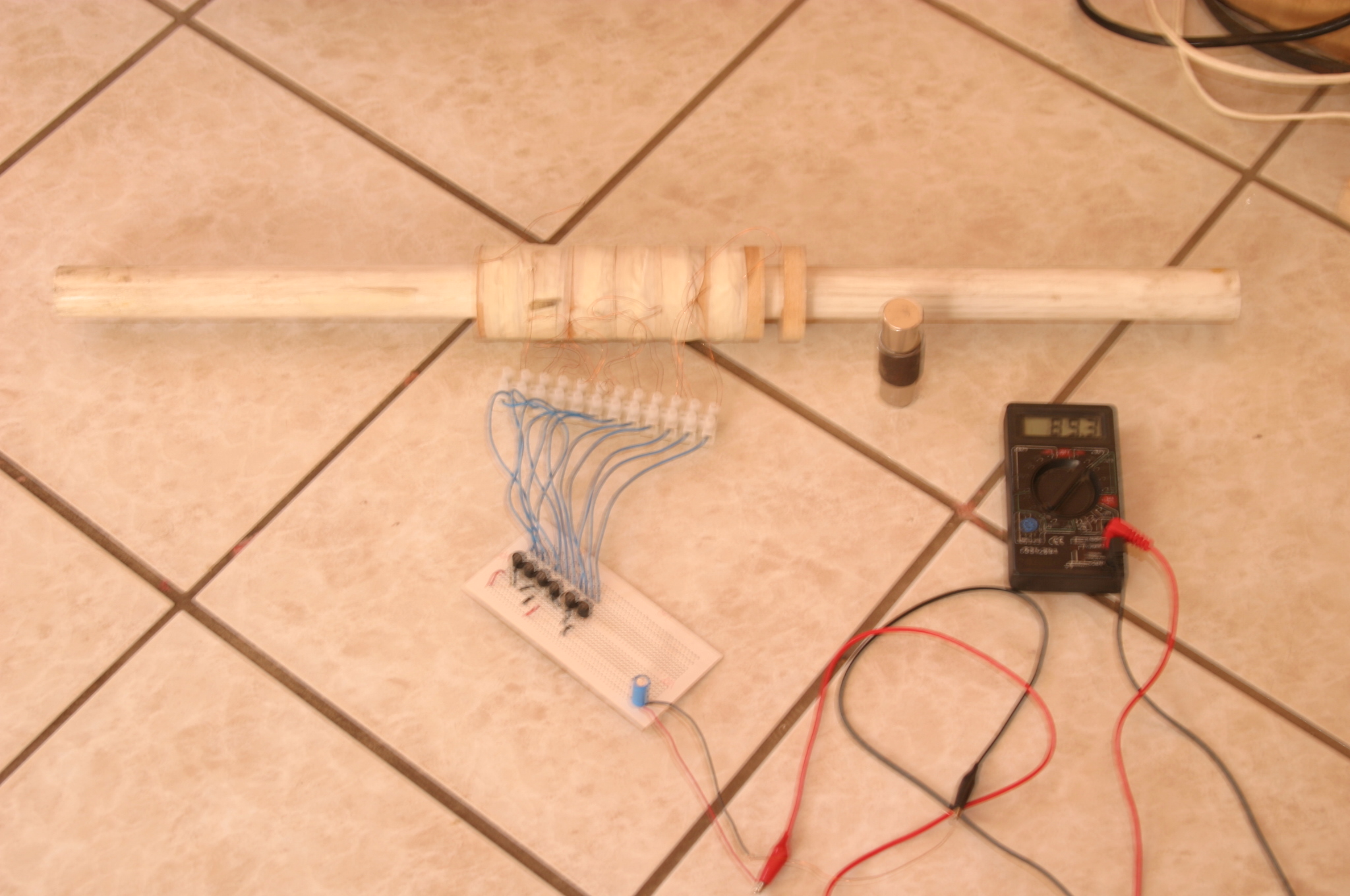

shaking alternator that aproach all wire and magnetism
Hi!

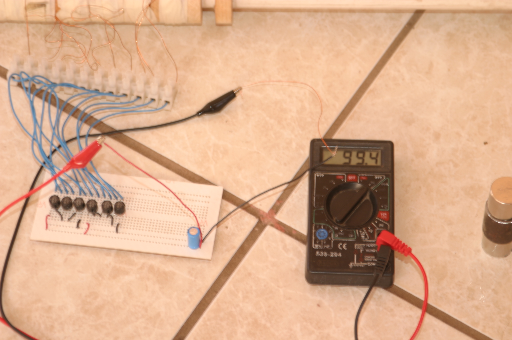

This is my last past time, it has 2 series of 3 coils conected in parallel #26 awg, 500 tourn aprox whit two neo magnets whit a special fix, you can see it, whit a piece of iron ron betwin neos, same poles attached to iron incress about 66.6 % current and volts. no waste in coils wire, all flux magnet squizze electrons. I like your comments. thaks.
Results: 107 vac, max current 0.350 amp, 53 vcd, all stored in a capacitor, each coil is conected to one rectifier.

sounds like a good match for a pumping style mill.
have the blade run a connecting arm up and down through the coils, and it will almost always run in a light breeze.
