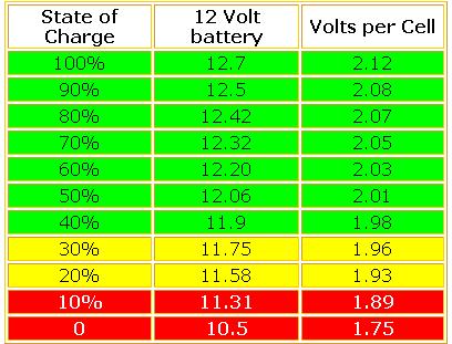

Hello!
Does anyone have a chart that give the voltages that a battery should go through in an 100% charged state.and in the stages that it goes through while in daily use. Say from 100% down to 50%. Please Advise

Here is one that might help you.
http://www.otherpower.com/images/scimages/10/BATTERY_TABLE.jpg

Question, divide by 2 for 6v batts? Would that be correct?
Also I have 6V showing about 3V, wired for 12v I would have only 6v then. Chart shows 10.5v at 0% charge? Does that mean the 3.3v batts are shot since wired in series I would have only a total of 6.6v still?
