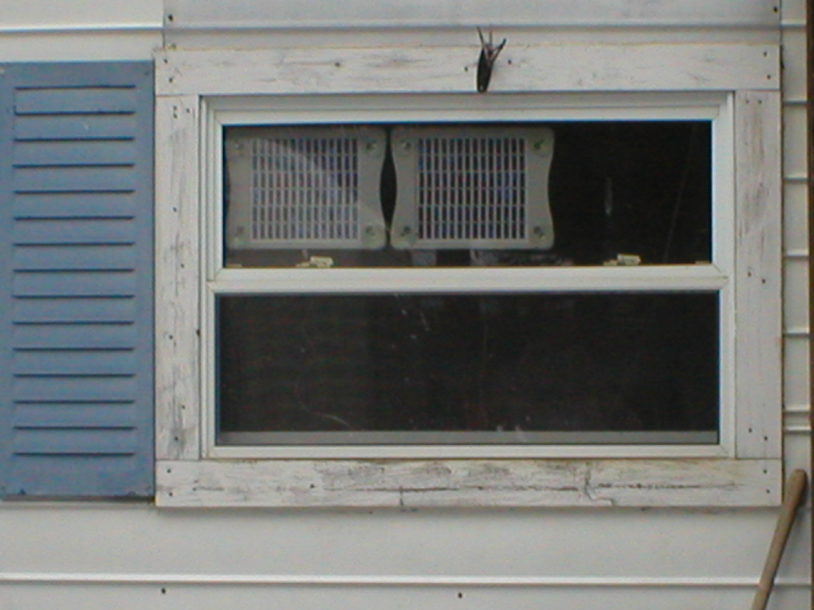

Back feeding VW PVC solar panels?
I bought one of those VW solar panels off eBay recently.  It plugs into the cigarette lighter to charge the car battery while the new car is in transit to the dealer.  It has a warning sticker on it that says it must be unplugged prior to starting the car or it will be damaged.  My question is why would this damage it?  I thought PVCs could be shorted or even take a back charge without damage.  Has anyone take one of these VW panels apart yet to see how they work?

Have no fear, they have a blocking diode in the cigerette plug, I think the warning is basically so some idiot doesn,t drive down the road with it stuck on the windshield. I use these same panels all the time, I even have them stuck in my house windows wired back to my battery bank, there not a bad deal when you consider that they are 3.2 watt. Thats not a lot of power, but price towo of them versus a 5 watt panel, the VW panels are a big savings.

The blocking diode is in the wire from the panel inside the plug end that plugs into your cigerette lighter in your car, I wish people that had no clue would leave there fingers of the key board, cant you see my pic and reliaze that I must know what I am talking about sence I am using some of the same panel.
