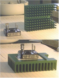

I just received 10 rectifiers, (600V, 35A) and I want to use a piece of 4" aluminum tube (about 1/8" thick) as a heat sink.
I will cut the "heat sinks" out of the tube and cut "fins" into them to dissipate heat from the rectifiers.  I will mash a flat spot into each where the rectifier is bolted on for maximum contact and heat transfer (with some thermal conducting grease) from the rectifier to the heat sink.
My question is, what type of BOLT do I use?  I am not sure if there could be a problem with dissimilar metals creating corrosion from electro-plating.  Should I use a zinc plated bolt?  Stainless steel?  Brass?
Please help.  I don't want to ruin the rectifiers.
Thanks in advance.

Seems like a lot of work. I just use a plain old piece of 18 to 14 sheet aluminum
or channel some heat sink compound and screw them on with whatever bolts I can find.
I am assuming these are fullwave bridge rectifiers. If they get hot use a bigger piece of aluminum. RobC

Yeah, I do the same. I get scrap aluminum from behind the shears at the ironmongers shop. Big box of odd pieces for a couple bucks. I use the strap type pieces as 2 blade hubs for Jerry Blades too. Seems like most factory built stuff uses non ferrous screws and nuts [non magnetic] so either stainless or plated brass but I just use whatever is in the fastener jar that fits. No problems so far.

The bolts arn't realy an issue, us what ever is cheepest.

Using a flattened piece of tube is not a good way to go because of poor contact.  The plat idea is premo...   Make sure you got the goop to insure heat transfer.

I've been using the heat sinks off computer CPU's - the older type found on 486 machines. Found a bunch at the surplus store for 50 cents each. The side that used to go on the computer chip is very flat, and the other side has lots of fins. They are made from aluminum. I just drill a hole in the middle, put some heat sink guck on them, and bolt them together.
Works pretty well and it's also pretty cheap!

I use Artice Silver for heatsinks on alot of stuff, one tube for my cpu's lasts forever! They also have the same type stuff that is more of a glue to bond the sinks and parts together, no holes or screws needed. Thinking about getting myself a tube of that too.

I think I'll still try mashing a flat on the piece of aluminum that I've got, just 'cause it's what I have on hand.
I'll definitely get some heat sink goo though.

What is the current going through each diode ?.
How many diodes ?.
These 2 questions determine what type of heat sink you need ( Volume, fins areas and some other factors.
The CPU shown in one of the replies to your message is good for 15-20 watts with a small blower on it, without it just 3-5 watts.
