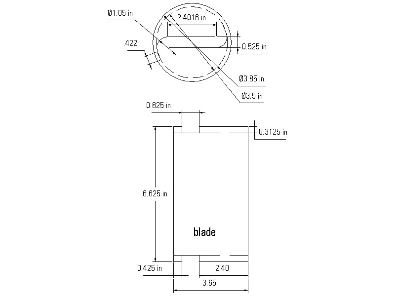

I built the Sandia Savonius from their patent
Ted (Monte350) directed me to this patent and I built a small prototype that was quite impressive.

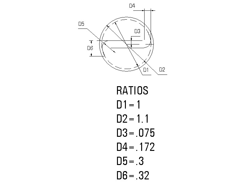

I posted this info on another post but somehow it was lost so I'll repost it here with the ratios laid out so some of you can give it a try.
Here are the dimensions for this mill that I made from step flashing that is sold in packages of 100 at my local building supply.
finally here are the Sandia ratios. They claim 37% eff and since this was a gov. project they are probably accurate.

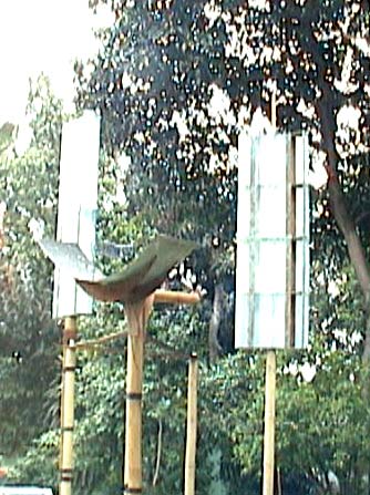

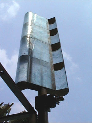

A few months ago, this post inspired me to also build that design.... my version is from ply and thin fiberglass-sheet... about 2' dimater and 6 ' tall..... All epoxied together on top of a bamboo pole.... spins like a dream with the slightest breezes from any direction.... silent too....
I'll be making the whole thing 'retractable' (for securing during storms) and will couple two of them (at right angles), with a bicycle chain/sprocket, on to one shaft.... to either drive a small alternator (for which I'm looking for a simple, cheap, 'developing world' solution), as 'stand-alone' charging a 12V battery, or as 'assistance' to a PV installation, providing 'some' charging for when the sun's not working.
I'm in Jakarta, Indonesia and looking for ways to turn the tropical sun and winds here into 'usable' sources for lighting and, most of all, refrigeration, especially in remote locations where services and parts are difficult... The idea is to keep the whole thing on the 'bycicle-technology' level so that a local bicycle repair shop can understand and repair and maintain them and parts are always available...
As a Dutchman, have grown up a long time ago cycling into the wind to school, and mostly also into the wind on the way back, I'm inclined to respect both wind-power and bicycle 'technology', plus I note that even Olympic cyclists still use chain/sprocket, so it can't be that 'outdated' a tech for transferring (small) work from one shaft to another (and maybe gearing it)....
Anyway.... Thoughts, ideas, suggestions, experiences, are invited....

The .37 efficiency was stated on their patent with .24 for a standard Savonius but watching this thing run I believe it as it spun right along with my props. A larger version would most likely be longer and my guess is that longer and narrower would still keep the high rpms. I don't think I'd make it any wider than 8" and any longer than 5'. As Dan said I'd have to figure out a furling system as I think this machine might have problems over 50 mph but I just don't know yet.
