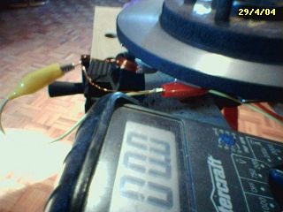

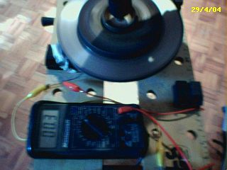

Well, i just did that a minute ago, here are some results...
This is the test jig, nothing elaborated.
Here are the 2 coils, the one to the right is too big and produce .3 volts at around 200 rpm.
This is the small coil. .6 v AC is nice for one coil at around 200 rpm.
This is the big one that hugh had me changed a while back. There is a hughe difference between the 2 even if winding is pretty much the same. ;)
Well, I tough I could make 3 phases of 6 coils for 18 coils totals but I see I will not have space to offset them on the magnets. With 16 mags and 12 coils, would I need to make the coils bigger than usual to have a wider reach?

Re: Ready to wind coils (none / 0) (#4)
by DanB on Fri Apr 30, 2004 at 08:20:46 AM MST
Its important to keep the inside dia. of the coils no larger than necessary - perhaps exactly the size of the magnets or a touch smaller.  If you use 9 coils:12 magnets, then the outer diameter of the coils can be such that they fit tightly together.
In your test - testing with only 1 rotor, you could assume that your output will be approx 1/2 of what youd see with 2 rotors.
Remember that your measuring AC voltage - probably RMS or some approximation, so after you rectify it youll have about  40% higher voltage - approx 1.4 volt drop across the rectifiers.
