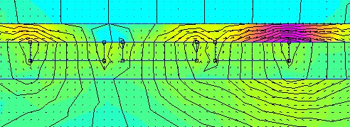

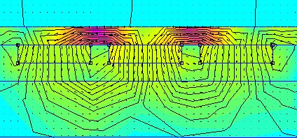

I've been trying to wrap my few brain cells around the slotted vs. slotless laminated designs for disk alternators lately. So I ran a couple of simple simulations with two configurations. I tried to keep the main parameters the same for both.
In the first simulation (slotless), the stuff in the screen shot from the top - 1st, a steel disk with 1" by .25" magnets (NdFeB40), then a .25" gap where the coils would lie, then a .75" lamination stack.
In the second sim (slotted), from the top; the same steel disk and magnets, then a .015" gap to the tops of the slots, then the same lamination stack, but with .25 x .25" slots in it.
Measurements in the slotless design in the simulation, pretty much .6 T anywhere in the .25" gap where the coils would be.
Measurements in the slotted design, taken in the middle of the slots, .5 T at the top of the slot (nearest to the magnet), .2 T mid slot, and .1 T near the bottom of the slot.
Now, I need some help with this! Is there something else going on with the slots, or would the slotless design look pretty good providing a good way to hold the coils can be worked out?? Help!

I think holding the coils is not a problem with slotless laminates.  But I think the .25" airgap you figured might be optimistic... depends I guess.
The field density you need to be worried about I dont think is whats in the slot.. but rather whats in the teeth passing through, and around the coil.  The slotted design is much more powerful at any given rpm assuming the magnet rotor is the same.

 The flux needn't go through the actual copper. The iron routes the flux around the copper which is the whole idea. Note that the slots can be very deep (limited by the physical strength of the teeth) containing lots of copper without increasing the gap at all.
 Think about transformers. Virtually all of the flux is in the core, yet fully coupled to the windings.
Victor

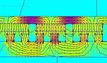

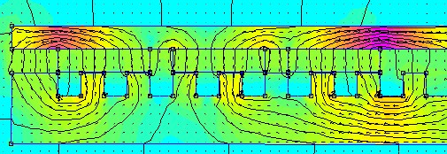

The pics above have alternating magnetic direction, ie the center magnet has North pointing up and the outer two magnets have South pointing up.
Here are the same simulations with all magnets pointing in the same direction:
Slotted -
and unslotted:

    That wasn't really what I was looking for, I was thinking in terms of the magnetic flux between 2 magnets, one set in attraction and the other in repulsion.
    Anyway, If you take a N and N or S and S and press them together the field extends, or in other words you'll get a larger field.  In the case of laminants all the plates become repelling forces.  You can see this by taking a few short pieces of steel and put them together like a laminant would be, dont glue them - simply hold them between your fingers and place them on a magnet.  Slowly remove the pressure on the pieces between your fingers and you'll find that all the pieces repell each other, If you try to bring them together the center ones will try to escape or get spit out because of these forces.  It sort of focus's the field into the wires.  If you measure the gauss on the end of each plate you'll find the difference between the magnet and the edge is fairly close to the same reading.
   Aren't magnets fun...
Have Fun! Windstuff Ed

Beginning to see what you're talking about. So the slotted design will cause more of the field concentrating on the legs of the coils passing through - and there will be more action for less magnet.

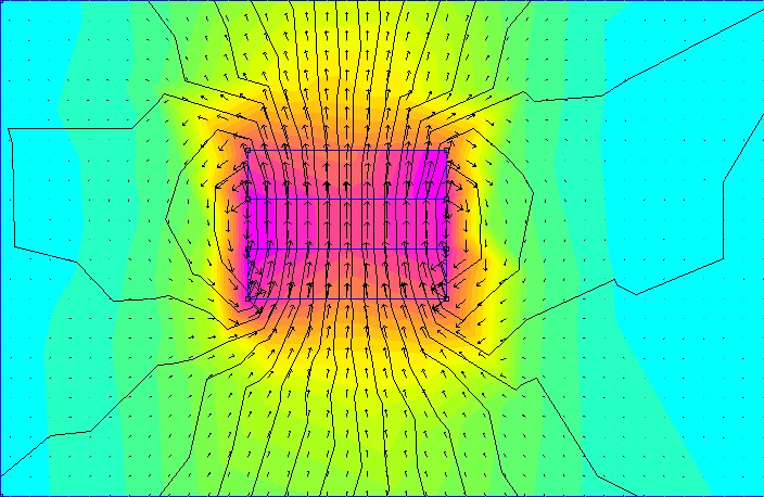

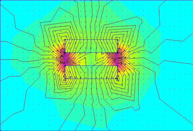

Two magnets in attract:
and the same two in repel:
Looks like slots!
Thanks -
Ted.
