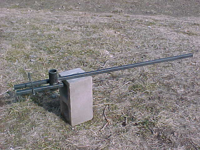

Hi, I'm looking for advice on mounting my pm generator. It is a 1/2 hp 90 volt pm type motor. It is heavy at 25 pounds. I am going to try it out with a quad set of aluminum blades. I would like to know if there are any plans available for a simple mounting device. My mounting pole will be 3" for 15 feet then reduced to 1 1/2" for additional 10 feet.
I also would like to know if the group recommends some governing (furling?) on this gen. I have found out from government sources that maximum expected winds are around 50 to 60 mph.

I  would try to include some sort of furling/governing device. Mount the motor offset from the center of the tower. Probably mounting it to the side of the tower will give you a couple if inches offset. You can then try to make some sort of furling tail. Fifty to sixty mph winds is a lot of wind.
This is a shot of mine furling. Hope it gives you an idea of what you can try.

First, mounting to your pole so that the gen can turn into the wind is what you need to look at first.  If your pole ins 1&1/2 inch, then a larger pipe that barely fits over your pole pipe is needed (much like two tent poles, except greased so that your generator can pivot into the wind).  On this pipe, (i guess a 2" one), weld some rebars at a 90 degree angle and long enough to reach past the middle of your generator.  This will serve two purposes.  It will allow you to attach your generator to the pole, but it will also offset your generator to the side so that you can make a furling devise.  It is also a good idea to mount your generator facing up just a hare (like three degrees or something).  This is so that your blades do not bend in strong winds and strike your pole.
You will need a furling system on your generator.  It only takes a few minutes of too much wind to fry your stator.  I have never heard of a place on earth that did not on occasion have some severely high winds for a short period of time.

Thanks for the comments. I think I'm understanding more each day. I think that a furling device would be a good idea. This is a basic mounting technique from the guy I bought the blades from. Is it easily adapted to a furling method? Some methods I've seen on this site are pretty elaborate. Would angling the tail piece away from the straight line be an effective furling method? I've seen lots of pix with the tail angled away. If so, how much? Considering that the end to end length of the longest piece is 6 feet (I could make it longer, if required), where would such a bend be made? Would offsetting the gen itself, be a good idea? I like the square tubing idea; it is easy for a beginner to work with and I can fab it up for my welder. Also, I think I'll double strap the motor for security.
I think mounting the gen up 3 degrees is a good idea for blade protection as well.
Thanks for any and all ideas,
Bill W.
btw, full credit to tlgwindpower for the picture
