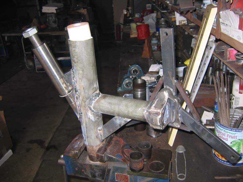

I have not had alot of time lately to play, but here is what I finished up this morning. I have all the material cut for the tail, however I have yet to weld it on. Maybe tomorrow I will do that. I have kinda built this turbine backwards from how I usually do things. The alternator is complete. All I have to do now is finish the 16' diameter prop. This one will be a monster.  :-)

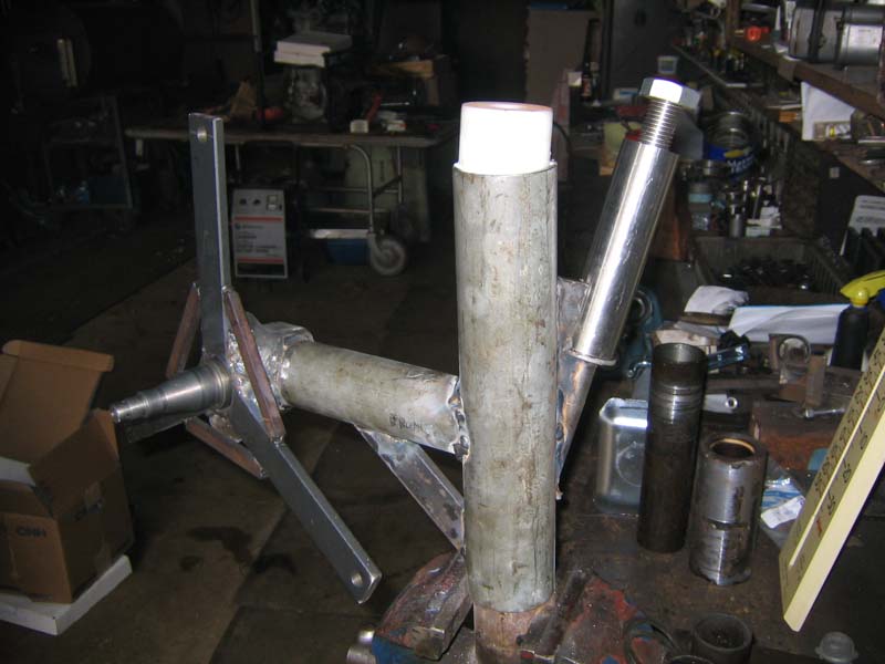

Here you can see the front of the assembly. I used 3" pipe for the vertical yaw tube. It is relatively thick wall, and is alot stronger than the original volvo strut towers we used in the beginning. The horizontal support for the volvo spindle is replaced as well, with a thicker, heavier pipe as to allow it to hold the alternator and in turn the prop. The alternator itself weighs in at close to 100 lbs. and the force a 16' prop will have to endure is substantial, so i wanted to make sure I built for strength.
Here is a shot from the rear of the assembly. You can see how I did the tail pivot and the stator support brackets. I might want to close off the end of the horizontal support tube to keep the rain out so I wont have any problems with rusting and water collection inside the tube. Ill do that later. I was concerned with overall weight and I chopped off all parts of the spindle assembly that werent necessary.

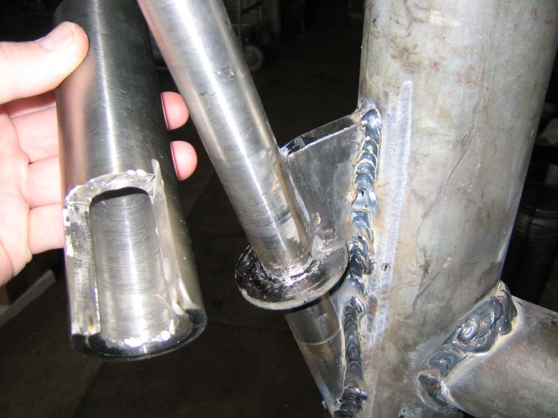

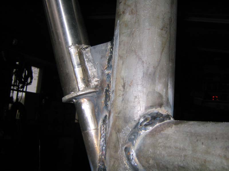

This is how I made the notch in the tail pivot. This prevents the tail from hyper-extending in either direction. It allows the tail to sit perpendicular to the blades in normal operation and when furled, it keeps the tail from swinging into the prop. If reinforcement needs to be done, it can be easily done to the back of the pivot later on, by simply welding more material behind it.
The pivot and the hinge is made entirely from stainless steel. It was a solid rod before I bored it out and cut the angle notch. The wall is slightly over 3/8" thick and I feel this should withstand all the abuse it is given. I might drill and install a grease fitting later, but as it stands, I dont see the need to grease it more than once. It will never rust and bind up. It is very strong. The tail on this machine will be 8' long.

Thanks Dan haha.  I wont bet you but, yours will probably be up before mine :-)    i still have to make a tower. Im kinda hoping one falls into my hands so -to -speak before im ready to put her up. I get alot of radio towers...being a ham and all and  the fact I do alot of antenna work.  :-P   but I think this machine will need a substantial tower. If worse comes to worse, Ill make one out of some heavy duty pipe. Ill have to wait and see. I have 1 million other projects im working on including rebuilding a 100 year old barn into a house for myself.  Just out of curiosity, is this similar to how you do your tail pivots? I have found this method works good if the pipe used to slip over the pivot pin is reinforced where the furl angle is cut out.  (if your not using as big of a hunk of metal I am).   :-)

Hi Roy - yes, it's about the same setup... just a bit heavier than mine.
On my 14' machine, I used 1" Thompson shaft for the pivot, and 1" pipe slipping over that.  The pipe is practically doubled up in thickness (reinforcement around the cutout for the stops and that runs up to nearly the top.  So - its strong, but 1" diameter is perhaps a bit small.
The machines were working on now we used 1" diameter pipe for the pivot, and 1.25" pipe slipping over that on the tail - and again, the 1.25" pipe is heavily reinforced around the stops and above....
The concern there is the 1" pipe, to do it over I'd go larger there - or use shaft.  I think it may hold up for a while though....
