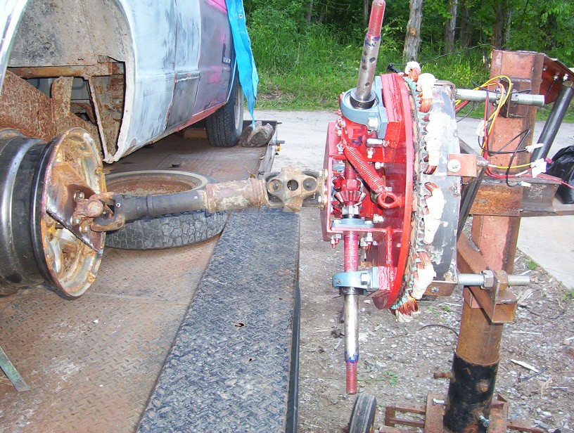

Hi All,   I finally found a way to test this monster and here are some results.
This is a front driveshaft from a 4x4. It's nice and short,it worked well.
 First some background info;  12pole,  36 coil,  72 slot,  3 phase,  24 mags,
 2x2"x1/2" neo's, 100 turns #18 wire, silicon laminations. I think that covers that.
      This is how the tests were conducted.
      4mm air gap, rectified DC and with a 50 ohm load.  (DELTA)
        Results:
        52 rpm------100V-----------1.76amp---------176watt
        132 rpm------200V-----------4.8 amp---------960watt
        225 rpm------500V-----------8.  amp--------4000watt
I was planning on a 5.5-6 meter (18-20 feet) prop 3 blade tip/speed ratio 7
230 rpm top speed.
I would welcome (most) any sugestions or comments.
 Marv.

Re: power tests (21" stator genni) (none / 0) (#5)
by marv on Tue Jun 15, 2004 at 02:14:49 PM MST
Ted; I want to charge a 48v battery system but I'm not sure if I have to use a
transformer or the batteries would pull it down to 48v. Anyone have a suggestion?
Tecker; I didn't test the torque at 500v but I checked it for startup. 16 foot lbs.
with a torque wrench.
Hannu; The design of this genni is mostly in my past posts with pictures.
thanks Marv

Re: power tests (21" stator genni) (none / 0) (#10)
by marv on Wed Jun 16, 2004 at 05:05:13 AM MST
Hi Michael;   The resistance of each phase is 7.7 ohms x3=23.1 ohms total.
The cogging at 4mm air gap isn't that bad considering the size of this. I checked
cogging with a torque wrench for startup and got 16 foot pounds. But with 18-20'
dia. blades that should be ok.
