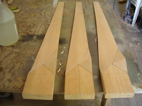

The blades are made from CVG (close vertical grain) Douglas Fir.  Very nice wood to work with, although we did have some trouble locating the direction of the grain in a few spots.  Nothing a disc sander couldn't handle.

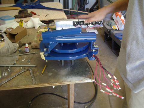

Darin Bird (blueEnergy's Director of Technology) welds the stator mountings to the hub case.  There was some internal debate about what to call the hub case.  Darin wanted "hub carriage" but I am writing this post and I prefer "hub case".

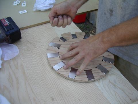

The magnets provided by WonderMagnet (2" x 1" x 1/2" NdFeB, Grade 35) are placed onto a steel rotor disc with the help of a magnet spacer jig.  The polarities of the magnets are checked by sticking a magnet in the hand and moving around the disc.  If all is as it should be, the hand is alternately attracted then repulsed by the plate.

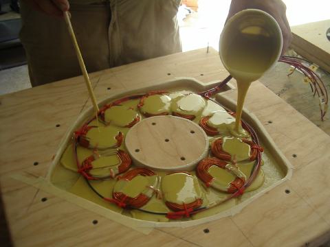

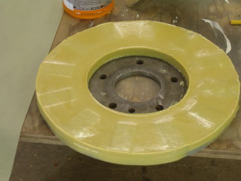

The stator is cast in resin.  A lot of man-hours are hidden in the soldering job to connect all the coils.
A resin-cast magnet rotor.

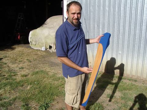

Darin holds up a completed blade.  The blade has 7 coats of clear as well as a partial layer of Blue paint.  The grain of the wood can clearly be seen.

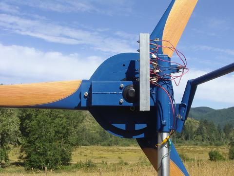

The majority of the hub assembly is put together.  The aluminum casing serves as a heat sink for the 5 bridge rectifiers that convert the 5-phase AC power to DC power for battery charging.

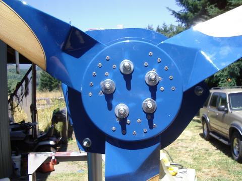

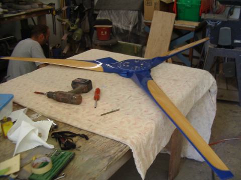

The blade rotor is assembled.  The tip-to-tip distances after assembly were within 1/8" of each other.  If we had more time we might have tried for 1/16" or even 1/32".
This close-up of the hub assembly shows how the layers of clear help integrate the wedges at the roots of the blades into the blades.

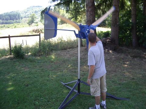

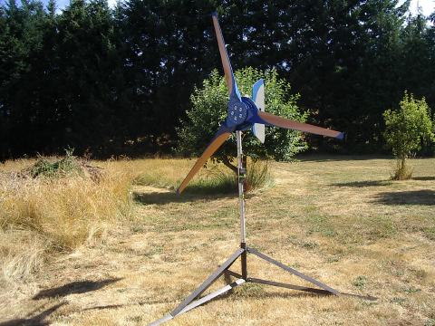

Darin gives the turbine a whirl.  When the turbine was left to spin in the wind (on the stub tower, amongst the trees), we recorded voltages (open circuit) as high as 50 volts.
