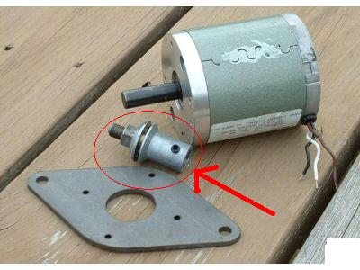

Looking for a source for this part
I'm looking for a hub extension for a servo motor that will allow me to mount a turbine to a servo motor. Anyone know where I can get one and what they're called :P

$1.99 each at hardware freight in left or right hand thread and 5/8 or 1/2 inch shaft sizes. TDM takes 5/8 on the 30 and 40 volt models anyway.

I think that Tom meant Harbour Freight, if not Harbour Freight has them.

those parts sold as a adapter for a motor to become a grinder or a buffer.

They are called a Shaft Adapter.  Try SurplusCenter.com or if you are in Canada and want to pick one up quickly then try Lee Valley for a 5/8" Shaft Adapter.
