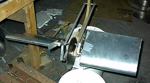

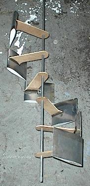

  I was going through a bunch of parts and pieces in my shop looking for just the right piece to fabricate into another stupid idea and ran into a couple old projects that I thought I'd share... These were disassembled and in the pile so I dug out what I could to partially assemble them.... don't laugh now...
This one was based on the lift theory and I wanted as much speed as I could get.  Each wing follows its own lift path and provides constant torque on the shaft.  Well It sort of worked spinning at around 1000 rpm in a 15mph wind but the power output was so low I decided it wasn't worth pursuing and ended up in the pile....
This next one should get a chuckle...  Another lift based design.  I had figured my ultralight wing would lift 1200 lbs at 30 mph it has a wing span of 29 ft and a cord of around 4ft.  This little gem was an off spring of what a wing will lift...
The wing span on this is 2 ft and a cord of 8 inches.  This actually works quite well ( still ).  In a 15 mph wind it will lift 50 lbs 1 inch 60 times per minute.  It runs fairly slow ( 30 rpm).   Each wing runs opposite of the other when one is on its way up the other is on its way down.  It runs on a crankshaft and the wings are timed to change angles at the top and bottom of each stroke.  The timing on the wing angle change is simply 90* from the power stroke.  It basically works like an engine only using the wind as the input power and the wings would be the "pistons".  Its built and timed just like a stirling engine and the offset of the crank throw reangles the wings properly.  Slow turning and an extreem amount of torque.  I had always planned to build a larger one to put on the barn and have a spare 14 ft wing section I saved for the project....

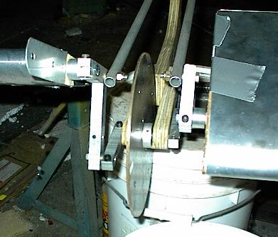

Here is a closer shot of the crank...j

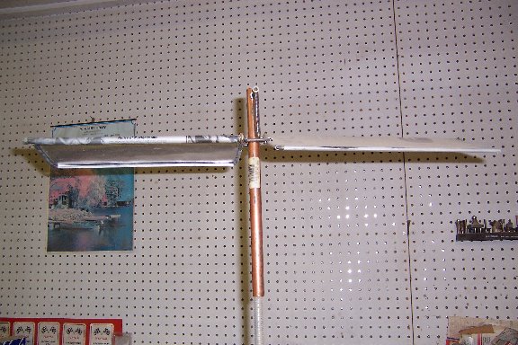

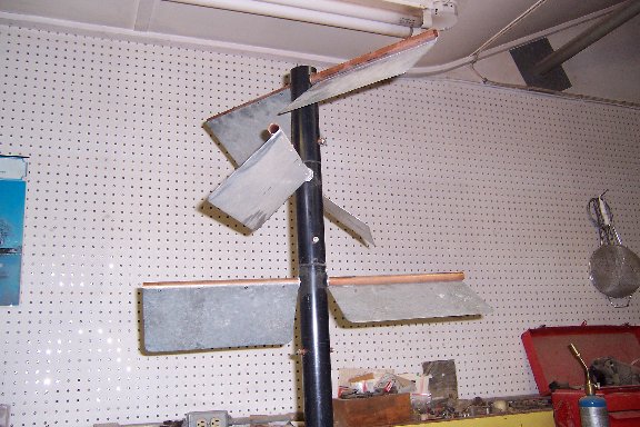

Here are a couple of my wacky windmill models.

    Thats a pretty slick little unit !!! Are the blades stationary or do they have some articulation?
    I've found just about anything will turn, twist, flop or break when placed in the path of mother nature.  I have alot of odd ideas, some are downright stupid but I like to tinker with my dumb ideas because usually they all lead to some really good ideas as well as what not to do next...

    It will lift 50lbs 1 inch 60 times per minute so that comes out to about 250ft lbs/33000 = .00757hp or 5.65 watts in a 15mph wind.  The model is fairly small, with a 2 ft wing span.  The frontal area, depending on how its measured comes in at around 1.33 sq ft.  I guess that makes it around 24% efficient.
    With the wings oposing each other it's like the blades on an HAWT and has a rotational torque on the machine which switches each 1/2 revolution.  This causes some massive vibration even at low rpm.   If I were to build a larger one it would only have one wing.  The power was drawn from the back of the trailing arms which increases leverage from the crank movement. The crank was basically used for a timing device and a way to move the blades.

      It has alot of potential as far as torque, like I said a 29 ft wing will lift 1200 lbs in a 30 mph wind, unfortunately it also runs quite slow.   Since it runs and moves the wings from the crank, a bicycle base would work well, like a 12 speed in high gear.  Another problem is its not easily moved into the wind although could be set up to do so even with a large wing span.  I really don't think it would make a good generator being sort of ground based but on a hillside it may have some potential.  It would also work great with the wings submerged in a stream with a reasonable flow rate.   Lots of possibilities for the wind motor.

  Ed, This second one looks like something that anybodys neighbors might not complain too much about... 2 wings slowy rising and falling about as hazardous appearing (except for the crank mechanism which you could enclose), as a couple of sheets hanging on a clothesline.

    It might look safe from a distance but with a large wing on it I certainly wouldn't want to be under it on its down stroke.   Unfortunately, ground winds are usually fairly tame since alot of the energy has been removed by obsicals along the way so unless it was on a platform it really wouldn't make a massive amount of power.
    Possibly, if it were mounted on a hillside collecting updrafts....  I built a wing for a larger one but never completed the project...
