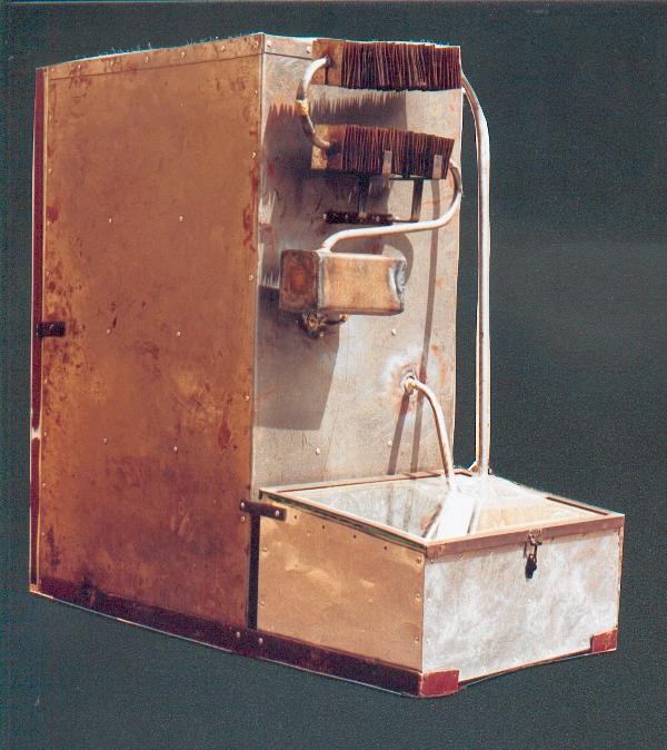

My intermittent absorption solar refrigeration unit.

The genrator is located inside the solar collector at the back of the system.

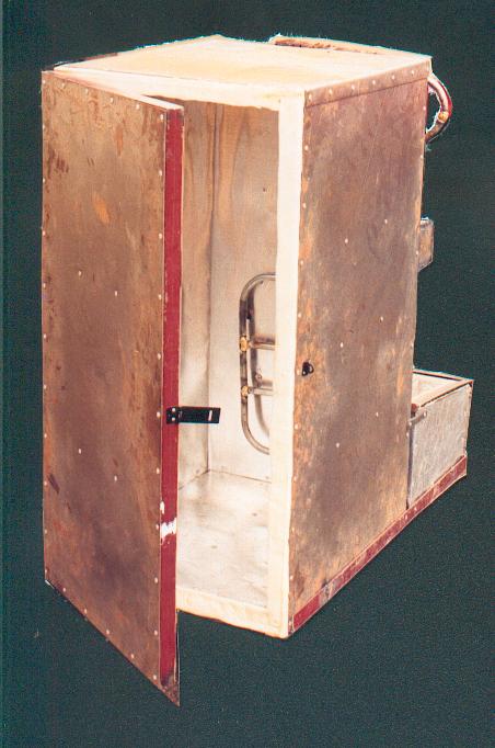

During the generation cycle, the ammonia in the anmmonia /water contained absorber  is vaporised and driven off. At the top of the system, the air cooled condenser transforms it to a saturated  liquid which flows by gravity through a check valve into a liquid reciever. The liquid ammonia flows through a restrictor into the evaporator located inside the unit. Block off the solar radiation onto the gernator and allow the system to cool. The resultant pressure drop will cause the ammonia to boil absorbing heat. The vaporised ammonia is reabsorbed into the genrator.
COP= 0.95.  At Miday in Dschang, Cameroon, temperatures in the genration box can get up to 95° C. Research continues. For best performance, the generator should be located outside the building and the refrigeration compartment located inside to prevent pre-cabinet heating by incident solar radiation.

by Julius Tangka on Mon Aug 02, 2004 at 08:26:33 AM MST
Like every solar system, there must be a collector of solar radiation. My unit has collector/generator located behind the sytem. This contains a mixture of ammonia and water in a sealed container. The box is covered by two layers of glass separated by a space of 5cm. All incident solar radiation is absorbed by the black body generator located inside the box and very little is lost. Consequently the temperature rises steadily until ammonia is liberated from the generator to the piping net work. The flow of ammonia in the system with various changes in state, results in the cooling of the compartment. Only the collector assembly needs to be outside although the heavy insulation of the refrigeration chamber prevents heat gain to the system. Like mmost intermmittent systems the heat source has to be taken away to allow the generator to cool. I do this by covering the collector from solar radiation.
