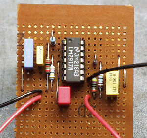

How I implemented it
The circuit is in PDF format. The pinout is for the 14 pin package.
tacho1.pdf
And here's a shot of the veroboard.
My 0-1mA panel meter is currently calibrated for 1000 rpm. I am optimistic, aren't I.
What I need to do is scan the meter scale, photoshop it, and print it to sticky paper.
Oh yeah, you can pull an analog voltage from pin 5. Feed it to a comparator for a star-delta switch. Or an rpm input to a mppt controller.
