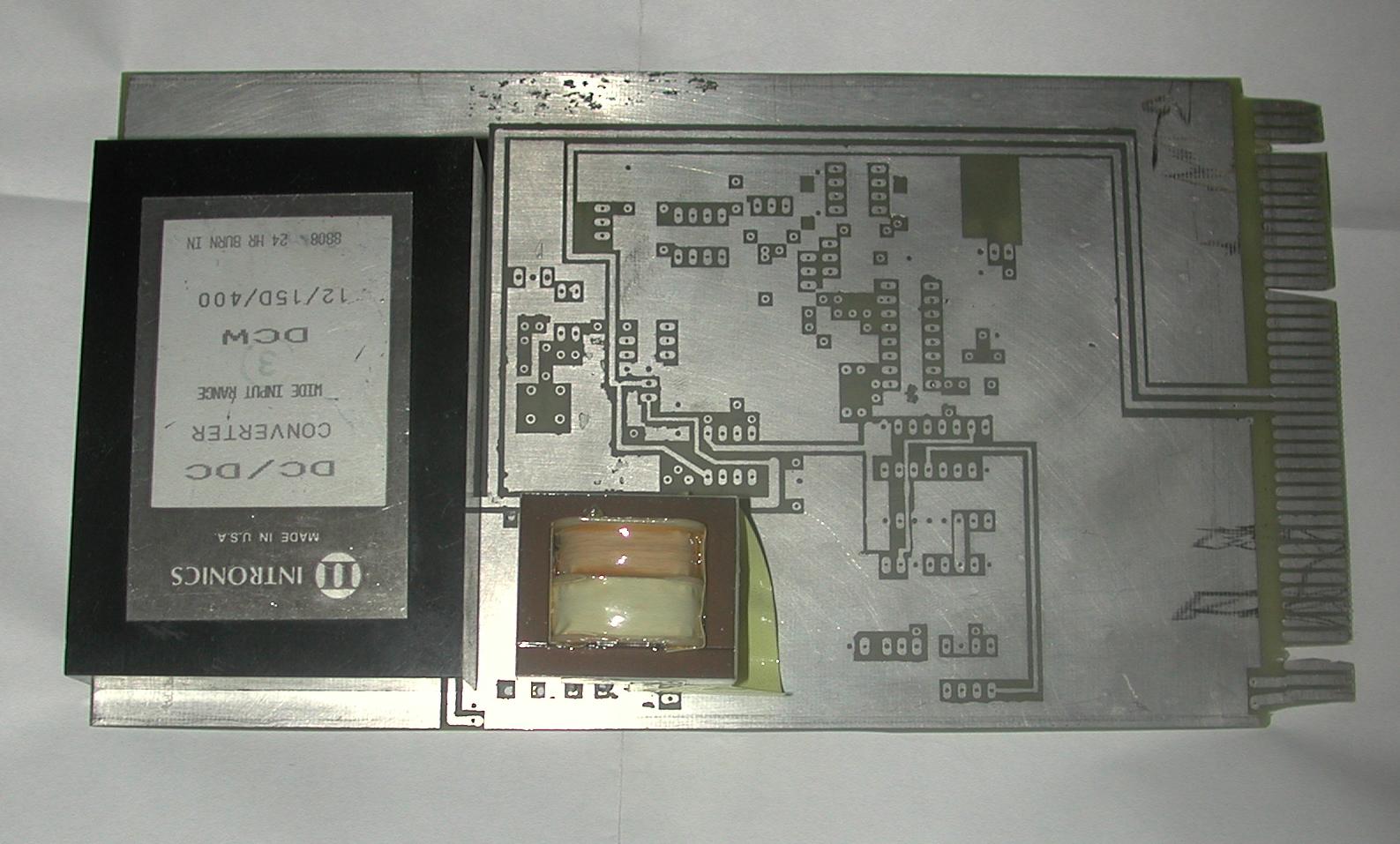

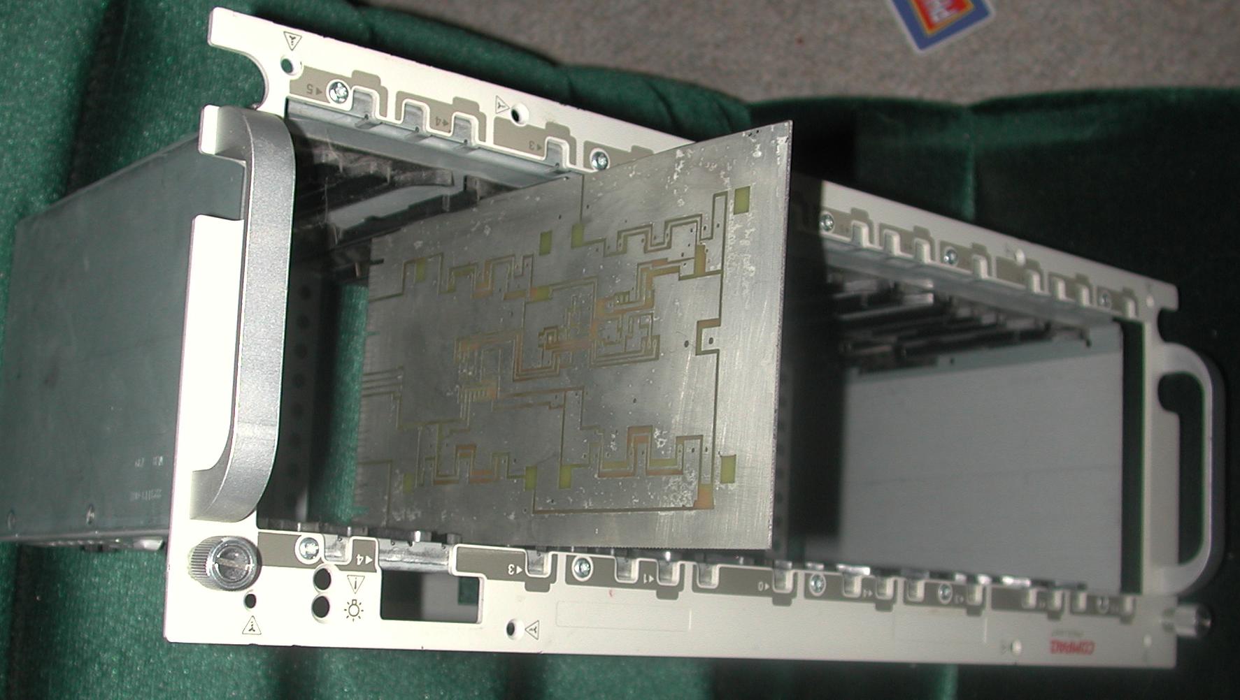

Re: Sine Wave Inverter (3.00 / 0) (#18)
by ibedonc on Mon Sep 27, 2004 at 10:25:16 PM MST
here a picture of the surplus card cage (ex drive cage)
and this is the new hand made PWM board , man is tuff to do a double sided board with the laser printer method
so it you want to do it like mine then you will have to find something simlar , on ebay or computer surplus  , or if you have a metal shop available :)
