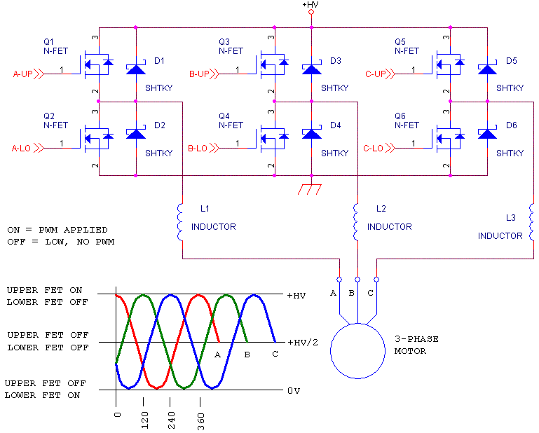

It certainly looks similar. Is there any reason why EV's use DC motors ? PWM control of AC 3 phase motors (using H bridges) should give you pretty good efficiency and does away with the field and the brushes, or am I missing something obvious ? Civic and Prius both use DC brushless motors. this article states the main reason is the simplicity of the controller as the limiting factor (cost). In the long run though it seems the money is on AC systems.

Re: Electric Vehicle Design (3.00 / 0) (#20)
by bill541 on Sun Sep 5th, 2004 at 03:15:31 PM MST
As you mentioned, I think developing a 12KW plus size inverter to run the AC motors compared to a simple PWM DC controller is one major reason. The other may be that regeneration is more difficult to do with an AC induction motor. A PM 3-phase motor may not be as bad for regen though.
The brush type DC motors are getting a lot of mileage out of the brushes these days, I think they change the brushes about the same time it is due for a bearing change. I guess this would depend on how hard you were hitting the motor.
I think where the AC motors really shine is when the battery bank voltages really get up there around the 1000V mark. Of coarse, the DC brushless motors can get up there too.
Basically I think it is the economics involved. Is it cheaper to do high power commutation with electronics or mechanical brushes? One advantage I can see with electronic commutation is that you can set the advance dynamically all via electronics.
-Bill-
Re: Electric Vehicle Design (3.00 / 0) (#21)
by bill541 on Sun Sep 5th, 2004 at 09:26:12 PM MST
Jacque,
You got me thinking about the AC drive requirements and how to do regen. After a bit of research, I think the simple explanation is that the controller drives a frequency lower than the motor is turning. The part I'm not so sure about is how the current is forced back to the batteries without damage to the inverter. I'll post back after some more digging.
The AC drive system that Siemens makes for EVs certainly looks like a very nice combination. Some information is available at http://www.metricmind.com/index1.htm
I'm not sure I agree with all of his arguments, but there are some good points.
-Bill-

I think that to do it properly you'd need some kind of encoder on each shaft, fairly low res, enough to be able to make a servo loop that is phase locked with the actual situation on the hub, that way you could always 'lead' the rotor by just so much to produce optimum torque.
Possibly a hall effect or gmre sensor right next to the magnets on the rotor would do. (cheap and reliable, no need for a spinning glass disc or something like that)
The regen may not be that hard in fact, as long as you make sure you keep your H bridge protected with diodes in series with the coils and fet outputs they are to all intents and purposes disconnected as soon as you stop driving them. Then you could open up the output lead from a full wave bridge that is permanently connected to the three phases of the motor and start drawing current to the battery. From what I get all it would take would be a fairly small inductor in series with every coil before the rectifier to go recover the energy.
No relays, just a chunk of high current devices (or a good sized bank of smaller ones).
The easiest would be to give each motor it's own inverter. More reliable as well (if you fry one it could be taken offline, the car would still drive and at the next opportunity you can switch it with a good unit).
For a pickup the rear wheel drive ones could be a little bigger, for a regular car they could all be equal.

Re: Electric Vehicle Design (3.00 / 0) (#34)
by bill541 on Mon Sep 6th, 2004 at 10:20:27 PM MST
Hi Guys, I understand how a 3-Phase motor gets up and running with a PWM input signal applied to the upper FET to pull the phase leg high with the other phase leg(s) being pulled low with a PWM input on their respective lower FETS.
I can also visualize that if all FETs were off and the motor was still turning, that the body diodes and freewheeling diodes form a bridge rectifier and as long as the motors peak-peak voltage was above the supply rails, current would flow back into the battery source.
The problem I am having difficulty understanding is how reducing the drive frequency to the FETs to a point below the free run frequency of the motor would cause regenerative braking. Say for example the motor was turning at a rate to generate a 60 Hz frequency and the controller was switching at a 50 Hz rate. Does the phase angle difference between the controller drive and the motors frequency cause an increase in motor winding current to the point that when the winding field collapses, the peak to peak voltage goes above the battery voltage, thus charging the battery?
Is this how they work or am I missing something?
On another note, couldn't this "active rectification" be used on 3-phase induction generators to make them produce power across an adjustable rpm range?
-Bill-
Re: Electric Vehicle Design (3.00 / 0) (#40)
by thunderhead (mail me from my homepage!) on Wed Sep 8th, 2004 at 12:39:31 AM MST
(User Info) http://www.simon.richardson.net/mailme.htm
Think of the motor as a generator delivering a voltage that is less than the batteries require.  So to charge the battery you need six boost convertors, which you time to coincide with the movement of the armature.  That means you need to know the position of the armature, but you need a rotation sensor anyway to run the speedo.
The six boost convertors are
  1. D1, Q2, L1 (+ve)
  2. D2, Q1, L1 (-ve)
  3. D3, Q4, L2 (+ve)
  4. D4, Q3, L2 (-ve)
  5. D5, Q6, L3 (+ve)
  6. D6, Q5, L3 (-ve)
You use them in pairs or threes, so one or two provide a negative current while the other one or two provide positive current.  The currents are set to always sum to zero, of course.
I think a circuit very similar to this was suggested for keeping windmills at their most efficient rotation speed.
Re: Electric Vehicle Design (3.00 / 0) (#41)
by jacquesm (j@ww.com- I run a whitelist, add 'stjoes' to msg) on Wed Sep 8th, 2004 at 05:37:00 AM MST
(User Info) http://www.greenbits.com/
OK, I'm not an AC whiz, let's see if I got this straight:
The frequency with which you drive the coils is the same as the one with which you drive it when you want to speed it up, you just time it so that the PHASE lags behind what the motor is doing at the moment. Sort of like an electric brake.
And because you have your phase lagging instead of leading you are actually drawing power FROM the motor instead of putting power into it.
The key difference with the way this was described previously is that they frequencey is the same, not lower. At least not right away, but as you draw energy from the motor it will slow down, and then you *will* have to adjust you frequency to match in order to maintain the same phase lock. That would be an ongoing process.
iirc correctly this is how the best stepper motor drivers on the market work.
Is that it ?
www.greenbits.com
Re: Electric Vehicle Design (3.00 / 0) (#42)
by thunderhead (mail me from my homepage!) on Wed Sep 8th, 2004 at 03:02:30 PM MST
That's the way I understand it.  The difference in phase between voltage and current is what causes the motor to produce torque: put the current ahead of the voltage and the torque is in the direction of motion, and put it behind the voltage and the torque opposes the motion.  In the first case, the electrical machine is a motor, and in the second it is a generator.

I have spent several hours over the last few days researching VFDs (Variable Frequency Drives) and how regeneration works in a 3-phase AC motor/generator. Haven't found much in-depth information yet. But so far, this is what I have found interesting.
The AC motor has two principal currents;
One called magnetizing current (Id) which is almost all inductive and lags the voltage by 90 degrees. This current is typically between 20% and 60% (33% average)of the full rated motor current. If a motor is run with no load, most all of the current is magnetizing current +/- friction and I2R losses.
The other is called the torque current (Iq) which is proportional to the amount of load applied to the motor. This current is in-phase with the voltage.
As far as regeneration is concerned, all explanations still say the the VFD drives at a frequency below the free run frequency of the motor. A speed sensor is sometimes used to ensure the drive frequency is always below the motor frequency for even braking.
In my mind the VFD drive current would only need to be able to satisfy the magnetization current requirements. Current begins to flow backwards in the drive circuts as the motor gives up its mechanical energy. I would think that the torque current is what you are recapturing.
It would be nice to see a "simple" vector analysis of the voltage and current in the motor and VFD during regen, maybe then it would make more sense.
