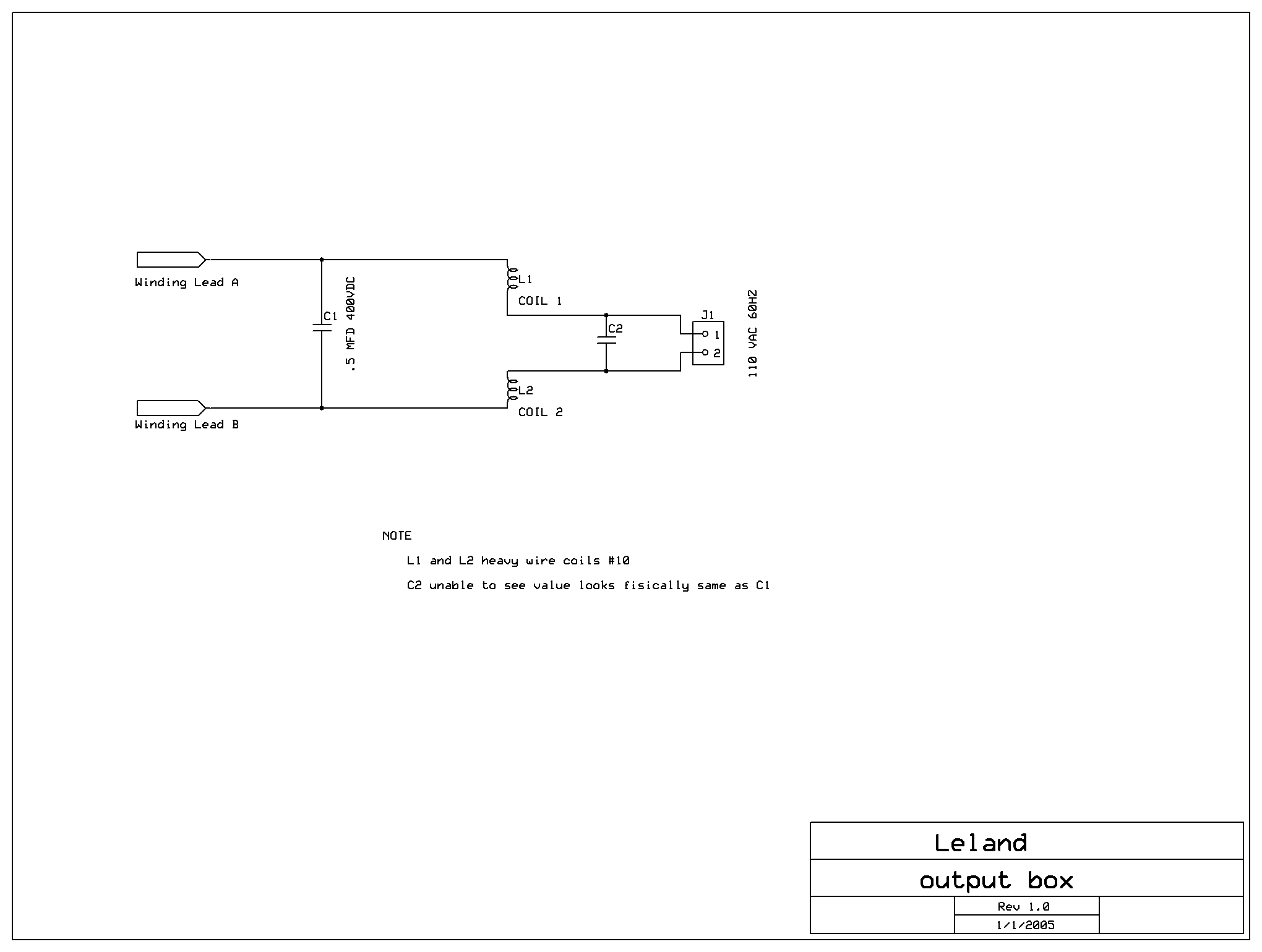

Hope this helps. First time trying to transfer a schematic so I hope it works. I wish I had adigital camera so I could photo this , but I'll do my best to explain.
C1 and C2 appear to be the same though I can't read the value of C2, C1 reads 2X .5 MFD 400VDC both are approx 2"X 2"x.5" case appears to be aluminum they are rectangular and do not have polarization markings. I'm not sure but I think MFD stands for millifared, .5 microfared would seem to be pretty small.
The coils L1 and L2 are mounted in a frame and sit next to each other, but appear to be insulated from one another and from case. They are #10 (or bigger) varnished copper wire. At first I thought they were some sort of relay but that is not the case. It's dificult to see bit the winding seeem to be more than one layer deep.
As I hope I showed in the schematic the caps are in parallel with the windings and the outlet plug and the coils, each in series with the output legs.
Well here goes with the schematic.
Re: Leland Altenator (3.00 / 0) (#5)
by drdongle (Dr.Dongle1@juno.com) on Sat Jan 1st, 2005 at 04:50:47 PM MST
I think what you have here is a NOISE filter

Re: Leland Altenator (3.00 / 0) (#6)
by wildbill hickup (wildbill_hickup at yahoo.com) on Sat Jan 1st, 2005 at 05:05:27 PM MST
Duh, choke coils well slap me silly. Guess I better get out those smart pills again. Thank's Dr.D
Re: Leland Altenator (3.00 / 0) (#7)
by drdongle (Dr.Dongle1@juno.com) on Sat Jan 1st, 2005 at 06:22:27 PM MST
Tis nothing Bill, I have had my hands in LOTS of military gear and the AC lines are always well filtered.

Re: Leland Altenator (3.00 / 0) (#8)
by Ungrounded Lightning Rod on Mon Jan 3rd, 2005 at 01:32:59 PM MST
I think what you have here is a NOISE filter.
Sure looks like one.
Is there another, BIG capacitor in the alternator somewhere?
Or some external-to-the-rotating-machinery circuitry (say to monitor a voltage and provide a small DC signal to another stator winding)?
