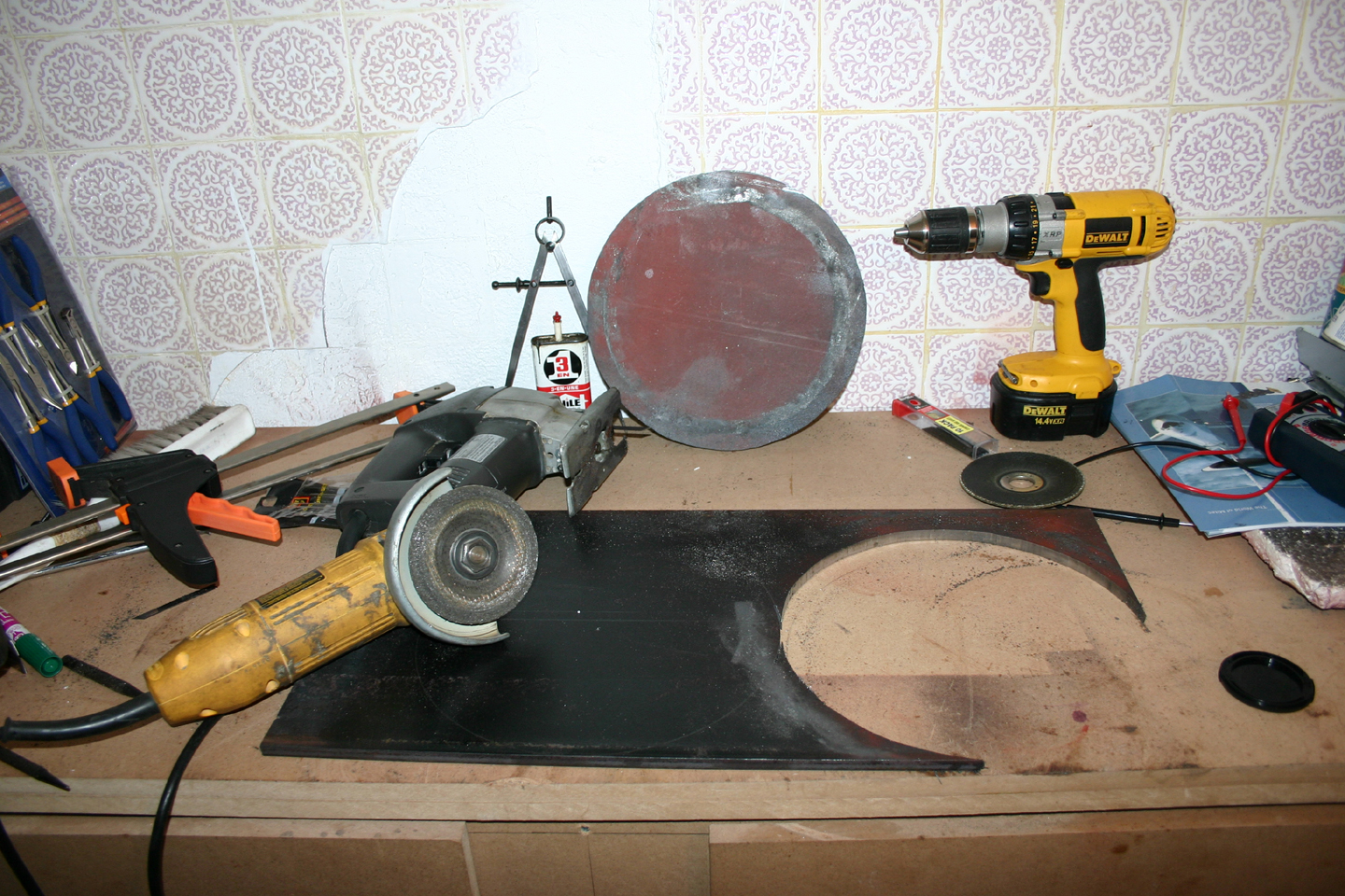

I have been collecting material for a dual rotor have yet to locate a hub that I do not have to pay retail for. Anyway, had nothing to do today so I decided to get started. I was offered to have my 3/8 inch plate steel cut with a plasma cutter but in the spirit of do it yourself I wanted to try and cut it myself. My tools were a 5.0 amp adjustable variable speed gigsaw and some blades for thick metal. I get a kick out of the package for the blades (it has a picture of an I beam on it). So I got to cutting first with oil then decided to cut it dry. Well in case anyone is interested it is working I am 3/4 of the way complete the first 10.5inch disk and still on the first blade. I stop every once in a while to let things cool off. If anyone was wondering how to cut thick steel hope this helps, now back to the gigsaw.

How fast is the cutting going?  I would think it would be a bit slow with a jigsaw...but, as you said, the DIY factor make it worth it. :)
Re: FYI-Cutting plate steel (3.00 / 0) (#3)
by Reno on Mon Jan 10th, 2005 at 05:05:29 PM MST
Not taking long at all.
It looks like 2 blades will do a a full circle and a little more. The first blade is still good for thinner plates. For anyone who thought they had no option but to pay well now they have an option.

    I cut a couple of disks 8 inch Dia. 1/4 inch plate and was thinking as I did it.....(dam...glad it isn't any thicker!) also...if I'm gonna do anymore of these I think I'll make a bandsaw  still  have the metal-cutting blade.... that goes to a bandsaw by Black&Decker You hooked up a half inch drill to a shaft on the saw ....was always going to buy it never got aroun to it.....some 30...40 years ago...(don't think they make them anymore! ??? LOL!  how time flies!

My uncle (a blacksmith) taught me a nice trick to save on the expensive oil used when cutting iron of all sort.
Dont use it at all!! - make a mixture of plenty of brown soap (the kind used for washing floors) and normal water. That has done the job for him for the last 20 years or so. just spray the soap-water onto the hot blade/iron, as you would normaly do with oil.
/Steffen
Re: FYI-Cutting plate steel (3.00 / 0) (#7)
by bob g on Mon Jan 10th, 2005 at 07:01:57 PM MST
i quit using cutting oils years ago,
i stumbled across one that is my favorite, coka cola
the water in it cools the bit or blade much better, and the sugar makes it stay in place quite well. a bit sticky, but it works very well
usually i use straight water now for all cutting and drilling operations, i have found it to work better than any cutting oils or fluids.
drilling truck frames one would have to sharpen the bit every few holes, with cutting oil, now with water cooling i can drill dozens of holes, large holes 5/8 to over an inch thru heavy plate.

Hi, It is all to do with cutting speeds and stuff, all amterial have their own cutting speeds. I am a sheet metal worker by trade and have had to cut all types of material. but when it comes to tough stuff, steels,titainium I use old thick oil, because you need a certain amount of cooling with lubrication, but when it comes to Aliminium, parafin is best or animal fat!. And as a general rule the slower the better - "if it don't cut it don't force it!" on lighter cuts you can get away with just normal soapy water. this link may help.http://www.coe.uncc.edu/~hocken/courses/SophDesign/speedchart.doc

by Reno on Mon Jan 10th, 2005 at 07:15:57 PM MST
Here is one of the disks I would say I spent about 15 minutes cutting.
The two points on the edges of the plate had to be grinded but other than that rather good result.

How this is this plate you are cutting ?
)}=- W o o f -={(
Re: FYI-Cutting plate steel-Pic of first disk (3.00 / 0) (#10)
by Reno on Tue Jan 11th, 2005 at 06:22:30 AM MST
3/8 inch I believe it is 1018 cold rolled.

Hummmm....By now I bet you probably wish you had taken the offer of cutting it with the plasma arc...Not much that can cut a plate with less distortion than a plazma arc..
By the way they make a very thin approx. 1/16" thick wheel for a 4.5 inch grinder that works real well and are fairly cheap that do a nice job of cutting steel . Happy cutting!

No, no regrets at all both disks are cut. I can assume you are saying this based on a predetermined notion. At worse my palm got a lttle sore from holding the saw but no big deal. If you run the speed just fast enough to stop the chatter of the blade and oil the plate as you go it is very easy cutting. I can say I have found it harder cutting some hard wood and trying to keep it straight. As I said I wanted to try this and let others who had no other options know if they really what to build a dual rotor. For what its worth hopefully it helps someone who thouhgt they were out of luck. I wish I could find a hub as easy as I cut the plate this has been my hardest or at least most frustrating part of this project.
