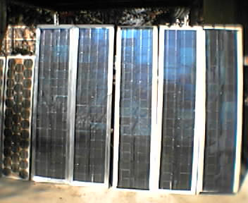

forgot to mention the size of my glass was close to yours.. mine was 26 1/2" x 28"..below is a picture of all the panels stacked and while i was in the room, i thought i would put a picture of my bear and moose....the bear was harvested in my yard up north....so, come on up and get yourself one!  :)pickster
