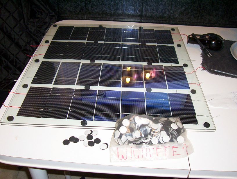

Also, since I just got here I havent had the time to sit down and go searching for all my questions unfortunantly. I wanted to know if there was anything wrong with building your panels out of wood. I havent even had the time to find what everyone else uses.
I've got 3/4" plywood base, with 1" rails/walls. With the cells connected to a piece of 1/4" ply so I can remove them easily without having to take the heavy panel itself. Instead of siliconing the glass on, I've use a rubber gasket and angle aluminum to hold it down.
Anything wrong with that?

hello pyro.......first of all i would have some reservation about using wood for a couple reasons, it's bending moment properties and it will swell when wet......we use glass on both sides...go to this very informative site Http://www.internetfred.com   and click on solar....internetfred has a pretty good page on it.....i think from an engineering standpoint if you had enough temperature to melt glass, you would certainly melt the cells themselves or the lead wires......although i have been shown that there is a wane or bow in glass sheets that have been exposed to the elements long enough. below is a picture of a panel ready for wiring...i have used sticky foam spacers but it has been suggested to use wood spacers.....again i have reservation personally about using wood as it will swell with moisture....some are going to fill the completed panel with oil to prevent condensation, but i am not sure at this point if this is feasable....i guess thats why we are testing....anyhow.....have a good one......pickster

Thanks for the comments. I know that's wood swells when it gets wet, and it also rots. That's why I coated everything in fiberglass resin to hopefully keep moisture out.
