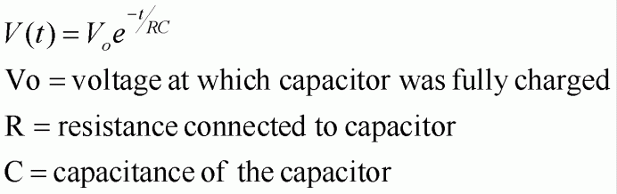

yes, they DO hold much more energy and can be discharged to 0 % but capacitors (if u draw their voltage as a funtion of time) u will find that it's an exponential decreasing function, so you'll need some way (which i have never heard off) to use them with an appliance that needs constant voltage....also.....their discharge is a function of the resistance connected to them........so good luck if anyone is gonna use them ....
Re: very large supercapacitor manufacturer (3.00 / 0) (#6)
by edy252 on Thu Jan 6th, 2005 at 12:36:27 PM MST
the equation of discharging is:
