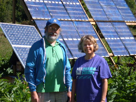

I must register one dissenting opinion. There are benefits to building your own solar panels. The biggest one is you will learn so much about the components of a solar electric system. There is joy in tinkering on something you built from scratch, and pride in watching it crank out the amps and knowing you did it yourself. If all you want is financial benefit then you'll be hard pressed to do better than buying factory made panels. But if you want a joyful hobby that will teach you a lot, by all means build them yourself. You will make mistakes, and some may be costly, but the knowledge you gain is one of those intangible things you just can't value enough. I think homemade can equal or exceed the quality of factory made if you are careful and you make well reasoned decisions and if you allow for your boo-boos. It won't be cheaper, but it will be better. Your best resource will most likely be this very spot on the web.
If anybody has any ebay cells gathering dust that they'll sell reasonable, I need one more panel's worth to round out my array (that would be 72 cells). See that hole in the photo behind me and the Mrs.? Please get in touch.  --tom

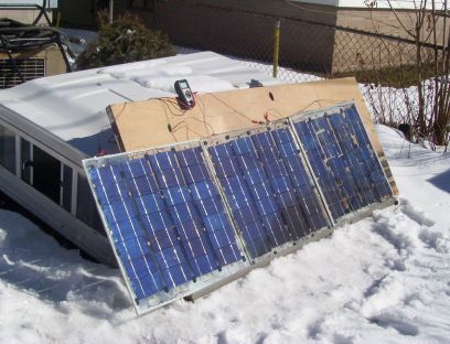

by cr8zy1van (salsa117@hotmail.com) on Wed Oct 12th, 2005 at 11:46:52 AM MST
I agree.. Even if you were to get the cells at a good price, by the time you calculate time spent and materials you could have bought a commercial panel and have a 10+ year warranty. No fuss with condensation, no cracking glass, no heavy wood enclosures. I may be a little jaded from my last experiment...
http://www.fieldlines.com/story/2005/8/19/235027/447
