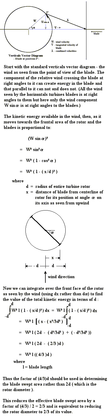

Someone with a handle like "cr8zy1van" shouldn't be asking questions with a mathematical content but then someone with a handle like mine, "Knucks the Knucklehead" (aka Anthony Chessick), shouldn't be answering such questions either. Verticals are fun mostly because there is still a lot not known about them. It is clear that these machines have two rotor surfaces seen by the wind, the front and the back, the front having a convex shape and the rear a concave one. These complicate the calculation of the blade swept area since, especially for the back one, it can be as large as the entire half circumference of the rotor circle or one half of pi times the rotor diameter. But this requires several assumptions including that the rear surface is taking the entire load and this is not the case. Having constructed several small verticals rotors of about 3 feet in diameter I see that it is often factors such as the air drag on the upwind side that has some controlling influence (at least on the efficiency) also.
If the assumption is made that both the front and the back take the load equally there is still a problem in that when the blades are near the outer fringe of their circuits (like a sailboat sailing nearly directly upwind or downwind) they are not as able to convert energy as when they are at the points where they are crossing at right angles to the wind (helped by the fact that the entire blade is at work at the rotor arm length rather than a declining amount over its length as with the horizontals blades).
To do the math for this, some calculus is necessary but it works out surprisingly well. Here is my cut at it:
I know it is a great disappointment for the fans of the verticals to hear that a factor of 2/3 should be applied to the rotor front aspect area, i.e. the rotor diameter times the blade length, but a serious look at what is involved leads to this conclusion. Just think that the horizontals have not done much better, few to none of them being able to produce even half of the energy that their swept areas indicate is possible under Betz at rated conditions and able sometimes to meet only 75% anytime other.
The 10 watts at 15 mph was found this way. The rotor diameter of the project in the message is 12" and the blade length is 18". This aspect area, 12" x 18", is 1.5 square feet. In square meters this is = .13935 m^2. This divided by a standard factor of .114 yielded the energy in kilowatts at the Betz limit for 30 mph winds = .1222 kws = 122.2 watts. Divided by 8 for 15 mph winds this came to 15.3 watts. But then the factor of 2/3 derived above was applied and this then resulted in 10.2 watts. For a device as small as this, that is quite good energy. For your device, 42" diameter x 34" blade length, this same calculation for a 15 mph windspeed yields 67.3 watts.

Re: VAWT swept area clarification. (3.00 / 0) (#7)
by IntegEner (mail@int.......com) on Thu Oct 20th, 2005 at 03:06:20 PM MST
(User Info) http://www.integener.com
I see a misplaced decimal point in my last. The standard factor for converting the square meters to kilowatts at 30 mph wind speed is 1.14 and not .114 . I have done this so often it is all committed to memory.
The verticals can be said to have a "physical blade swept area" as others have mentioned and also an "effective blade swept area" which is less and is equal to the former times the factor of 2/3 that I have been suggesting.
I think most everyone would agree in general terms with this.
