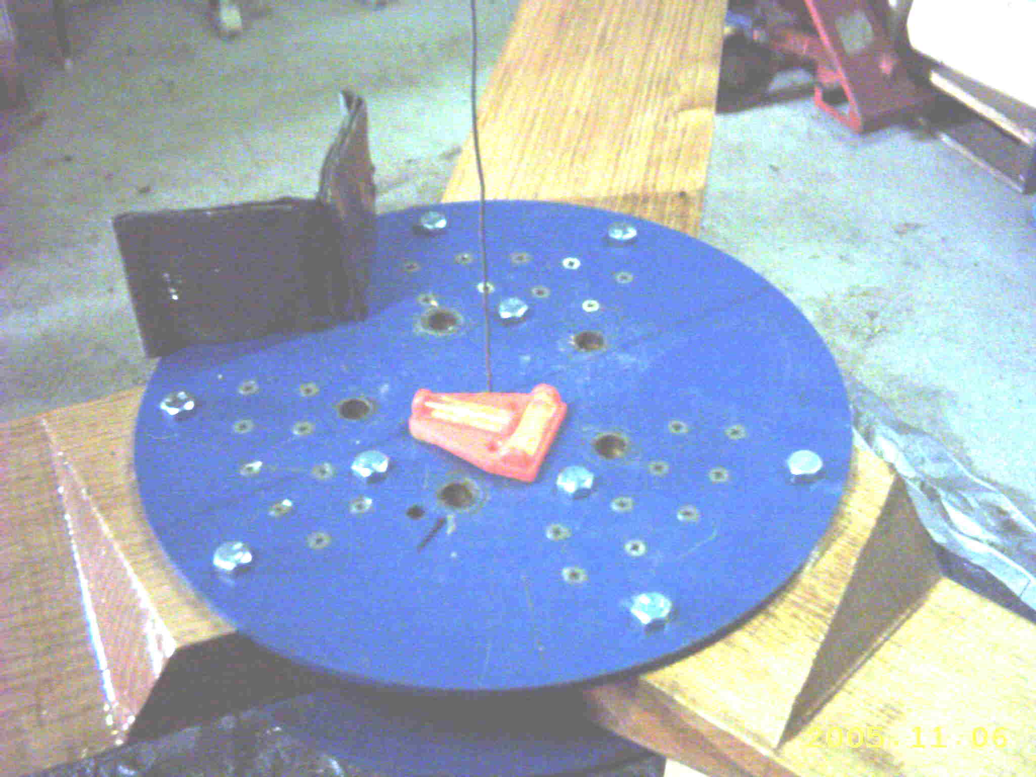

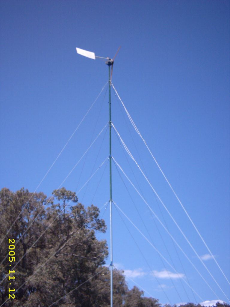

Finally we have the re-born tripple rotor up and flying as a duel rotor, OK it's a long story best suited for a diary entry later. It's fallen from the sky twice, a steep learning curve which I will share as time permits.
As always little wind since raising, but have seen 16amps briefly @ 24 V system.
Its a Hugh Piggot duel rotor design built for 24V using wedge shape magnets 40x20x50mm 5mm thick doubled up. Coils are 135 turns of bifilear wound 0.9mm.
The blades are 3m diamiter made out on Oak, our first blades from Oak but its very straight grain.
This time the angle from root to tip is linear, and they run much quiter.

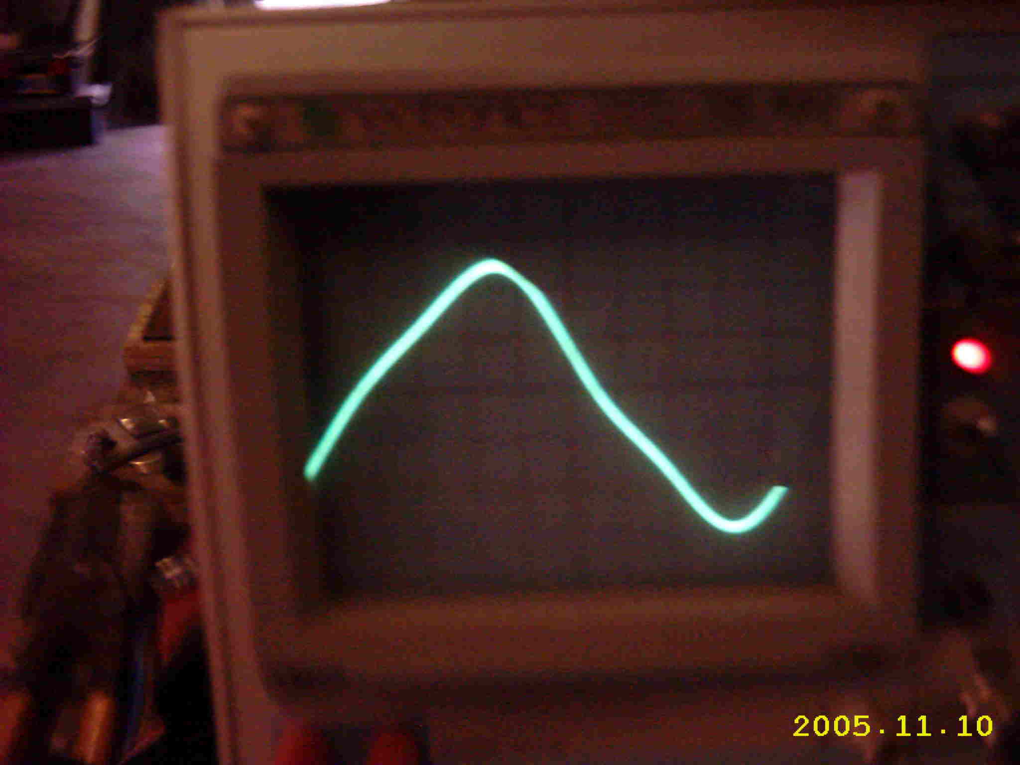

Cut in is 185 rpm @ 25 volt or 7.33 rpm/volt.Wave form.....

   Those oak blades really look good, and smooth sine wave -- that must be that beautiful inverter I saw in your files !!   (I need one of those !)
   From the look of the guy wires, you aren,t takeing any chances with this one either --(nice erection!!)
   Will have a new tower up soon myself, and hopeing I can get clean air then, insted of the turbulated stuff I get now !!

    SORRY, after i read it again, I realize the wave pattern is from gen !!

OK the winds arived last nite seen Phynix doing 30+ amps at times into the 24V system, albiet it was at 31V by 6am.
So it works spiffingly, blades are almost silent even in good winds so I know what profile all future blades will be.

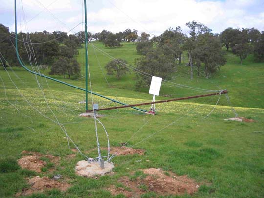

Its come a long way from here
but you get that on the big jobs.

   Hey Allen,That pile of bent metal, and "Grounded generator", looks nasty -- and you sure have advanced from there !!

Agreed on diamiter, it's been a very steep learning curve made worse by the fact that I do/should know better on tower design.
But we now have data on tripple rotor and duel rotor. When the tripple threw a weight, I tried shorting it out to stop it, well I should have been Scottish and Pi***d into the wind. It just made more amps, like 80A, the reast is history and we still have not retrieved all the magnets.
