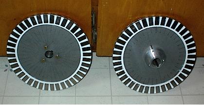

This picture shows what I mean by a wide core as long as the magnetic path lenght.
Active lenght is interpreted as the "lenght of the wire in the magnetic field". Outside this there is no active field thus nothing happening. The conductor must be above or within the region of magnetic activity.
To awnser a "round coil is the "least" efficient shape for a coil", yes and no. At the moment it works, but this could change. We are consistantly seeking a better coil shape which would lead to better output, at the moment round and alongated is in. it meets all the primary conditions.
Yes, I too like the angular velocity to linear velocity exchange! And just think of the power of a slow moving vwat with a diameter of 2ft and lots of magnets and coils around the bottom!

  iFred,  Nice job on the faraday post, quite interesting.   I might add that for each degree of angle in the wire under the magnets there is a decrease in output that coresponds to that angle.
  I think the larger diameter is a slight misconception.  I don't believe you have to go with a larger diameter to increase output.  Going to a larger diameter is more of a convienience.   What I mean by this is that it would be easier to add more magnets and less wire on a larger diameter than to work with a smaller machine.  But... I can be done with the smaller machine using the same rpm.  It's more convienient to use the extra "real estate" of a larger machine with more magnets.
  Given the same magnets on 2 different discs,  12 poles on an 8" disc will give you better performance than the same 12 magnets on a 12 inch disc.  Even though the magnets on the 8" disc at 200 rpm are running 418 ft per min and the 12" disc is running 628 ft per min.  Given the same coil layout the flux change is the same no matter where you put the magnets at the same rpm.  Also you'll use a bunch more wire on the 12" disc which will lead to less performance. So the smaller disc will perform much better overall.  Now, as you said, lay out lots of magnets and lots of smaller coils then you'll gain in performance. Below shows the magnet discs of the 2500 watt machine I built some time ago using small magnets these are 10" discs...

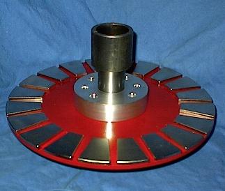

The one below is a 48 volt 1kw unit built for a VAWT for a company in Canada.  It runs at 1.5 rpm per volt on a 12" disc.  Originally designed to be on a 10" disc but for convienience I built it on a 12" disc
So unless you really need the real estate there is no need to go bigger.  Look at Dans 17 ft machine built on a 16" diameter, low rpm great performance.  Still pretty small for the machine driving it ( I think anyway ).
