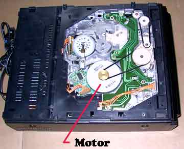

The 3 phase permanent magnet alternator is from a VCR.
Only the bottom plate was removed for the photo.
Most of these motors are held in with 3 screws from the top, and are very easy to remove.
The wires connecting the motors are unplugged.
The large disk on the front of the motor is probably held in place by magnets and a small plastic washer on the axle. Often the shaft can be pushed, removing the assembly as the washer slides down the shaft, but sometimes they need cut off.
Save the washer if it comes off easy.

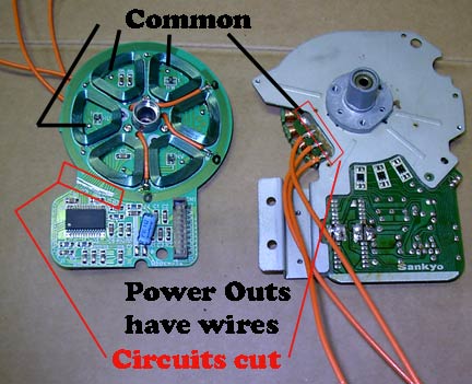

There seems to be 2 common types of this motor.
The bad motor is subject to very strong eddy currents in the metal backing plate, and is not very usable because as the RPMs increase the drag increases to an extreme amount.
These motors are wired 3 phase star, meaning the 3 phases are connected together in one place, and each of the 3 phases have the other end going out of the motor.
An Ohm meter is needed to tell where the 3 motor output wires are located.
The 'good' motor in the photos has the common connections and output wires very easy to see and connect wires to.
The traces or conductors on the circuit boards were scraped away with a utility knife, just to be sure no power was being fed to the circuits.
The 'bad' motor had 3 holes drilled to get the wires out the rear.
Output wires are soldered to the ends of each phase.
This link by DanB has a nice drawing for 3 phase.
http://www.fieldlines.com/story/2003/9/11/84741/6758
Each phase has the same ohms reading.
This 'good' one is about 4 ohms.
From common to any output is 4 ohms.
From any output to any other output is 8 ohms.
From any common to any other common is about 0.4 ohms, but that is from the wires on the meter, and is almost the same as the ohm meter test lead to test lead.

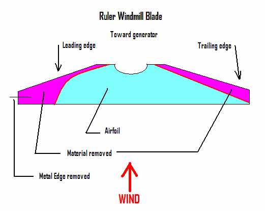

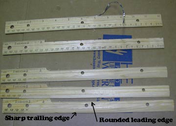

Wooden rulers make simple blades.
Part of the angles are ready to use!
I removed the metal strip, marked and cut off 3/16" along that side, from 3 and 1/2" to the end.
The blades are sanded for a trailing and leading edge.
A bench mounted sander will make things faster and easier.
The root, or center, is not changed.
The root angle is needed later for fastening to the hub.

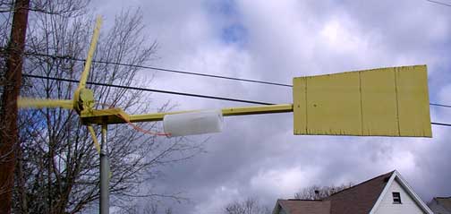

This 'tower' is a section of 1/2" metal conduit.
The photos show the 1/2" conduit inside a piece of 1" copper at the bottom because that is one of my test towers.
The windmill nuts and bolt is simply placed in the conduit.

This windmill can make about 8 or 9 volts AC per phase under a load of about 25ma when spun by a flick of the fingers. I have no idea the RPM at that time.
These LEDs were placed in a half clear plastic tube in the first photo. The whole thing lights up very nice on a dark windy night.
Only -RED- LEDs!
Red colored plastic red LEDs are hard to see light up in day light.
"Water clear" red LEDs show up when lit the easiest, by far, because as soon as they light they turn red!
The blades could be a little shorter, maybe about 10" each, or even 9" for this particular alternator. Then the windmill would spin a little faster and the LEDs would light up sooner.
This particular windmill needs about 14 mile per hour wind, steady, not gusting, to light the LEDs with the 12" each blades.

It seems tougher than I expected.  I was waiting for the blades to fail. About 12 weeks of pretty harsh weather had very little effect on the blades.
So I gave up waiting for a failure and just slid out the blade & hub assembly and removed 2" from each blade. More effort was spent on better balancing this time.
As expected, it takes a little more wind to start turning.
Once it is turning, it turns MUCH faster than the 25~30% I expected it would. Possibly double the RPMs at the same wind speed.
Now I expect the LEDs to light up about the same time my wind gauge will register (6mph).
The 12" blades may be better set at 5 or 6 degrees?
Big Silly Fun!

Put a set of Rich's 12" blades on it.
Wow!

The ruler blades after being cut down to 8", in a strong wind, are Very Fast!
