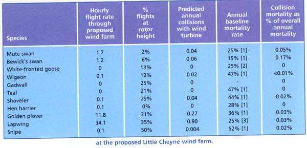

birds and wind turbines some facts! (3.00 / 0) (#12)
by Jon Miller on Thu Dec 01, 2005 at 01:38:07 AM MST
Hello all
I have got some facts about bird death rates from a 'Environmental Statement' book for the local (about 15 miles away) wind farm with a praposed 27, 2.8 Mega watt, 150 feet tall turbines.
Thes figures include the fact there is a large bird sanctuary located 5miles away from the site they have chossen.
Rember that these figures are for 150 feet tall turbines with 90 feet diameter blades!!
Hope this helps to show you its very unlikly you will kill many birds if any!!  Regards
Jon M www.otherpower.co.uk
