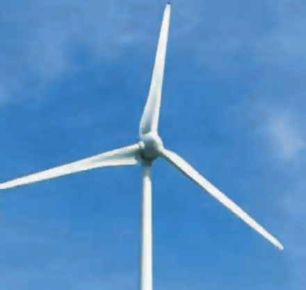

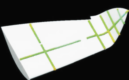

Since winglets are proprietary data, studying working turbines may give clues. Unknown if these pictures are accurate size wise. Enercon uses a low rpm design - three pictures lifted from Enercon's 'windblatt' newsletter showing wingletts follows:
Looking like a whale flipper w/ tiny winglet just visible:
Exagerated winglet perhaps?
Top blade you can see the winglet shadow:
Anyhow - thats my two-bits worth...
