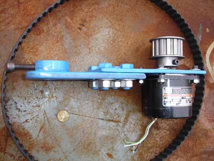

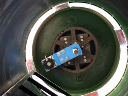

i was not able to get much voltage from my tape drive motor except in high wind.(even after gearing it up). WELL........i fixed that problem. now i have a stepper rated at 120v 70RPM. it really cranks out the juice. in low wind its usually putting out around 10-25 volts ac and max is about 100vac. it can easily be converted to dc with a bridge rectifyer. turning it slowly will light 3 mr-16 LED fixtures very easily without any noticable load. i don't want to charge batteries but just to light up some lights when the thing is spinning. i found a LUXEON fixture which runs on 12-28 volts.

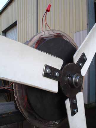

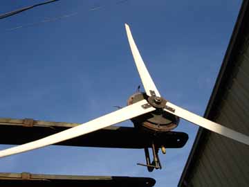

and here is a traditional wind alternator almost finished. i bought hugh piggott's plans and they are great. dual axial, 3-phase, 12 wedge magnets, 9 coils of #11 wire 40 turns, 7 foot PVC prop. we'll see what happens, so far looks like its going to have to spin pretty fast to come up with 12vols.

Aaron could you post more specs on the stepper motor or better yet another photo of just the name plate?  Thanks,
zap
Re: Update on Lighthouse Sculpture (3.00 / 0) (#14)
by Aaron on Wed Dec 28th, 2005 at 11:00:18 AM MST
zap, the plate is worn and you can't really read it all. basically, its rated @ 120 volts and 70 rpms. i think this type of stepper is readily available.
aaron
Re: Update on Lighthouse Sculpture (3.00 / 0) (#15)
by zap (bell47g5a at comcast dot net) on Wed Dec 28th, 2005 at 09:44:23 PM MST
Thanks Aaron, I had tried a few google searches, i.e. stepper 120 volt, and stepper motor 120 70 rpm, and variations of all of those and just never was able to find a stepper with your specs and that's why I asked for the pic.  I shall continue the search.
