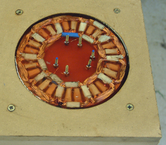

Trying to get small amounts of electricity on a small scale at low wind speeds
I have been trying to build a 12v wind generator to do nothing more than just trickle charge a car battery.
The output needs to be just over 12v to charge although the current need only be quarter of an amp or less.
I also need it to produce this at very low RPM ideally 60 RPM as I am using a multivaned prop of about four foot diameter.
It turns well in very light winds producing a good torque and reaches a maximum of 120 RPM before it is set to tilt out the wind.
I set about building a three-phase generator with 10 coils per phase, each coil having 40 turns equalling 400 turns (26swg 0.45mm) per phase.
I have two plates rotating either side of the coils with ten ¾"x1/8" disk magnets totalling 20 magnets.
I tested the output by spinning the generator on a lath, initially I was using half inch magnets and got less than 1 volt!  I then refitted the generator with ¾" inch magnets.  Now I get about 2-3 volts.  I increase the speed to 600 RPM at the speed I get 12 volts open circuit and 7volts under load.
I have concluded from this that I should be using thinner wire and very many more turns if I am going to achieve 12 volts at 60 RPM.  It also seems it is much harder to produce small amounts of electricity on a small scale than larger rigs as everything becomes more critical and leaves less room for inefficiency!
Has anybody got any advice or suggestions as there seems to be a lack of information about generating electricity on this scale?

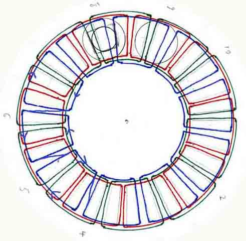

Your magnets are very small and you are right that you have to increase the number of turns.
To be realistic I think you need to use 16 poles ( 32 magnets ) of that size.
I would do it in a single layer winding with 12 coils with those round magnets.
I think you could get your cut in at 60 rpm and manage about 1 amp at 120.
If you can live with less output then you may get away with 12 poles ( 24 magnets) and 9 coils.
It is perfectly possible to produce a silent machine with a better propeller with a tip speed ratio of 4 that would let you use a lot higher speed, but it is perfectly possible with your sailwing rotor.
Would be much easier to start with some decent magnets such as 2 x 1 x 1/2".

Sounds like good advice, if I increase the diameter and have as you suggest a single layer of coils there should be room for 16 poles and 12 coils.
I wonder what gauge wire should then be, I guess it wants to be fairly fine as if it is to large the resistance will drop and the current increase as far as I understand.  This would surely then increase the drag and at low rpm such as this, may stall the mill.
You suggest I use larger magnets 2 x 1 1/2" difficult to know quite how to pitch all these variables.

Stall is not going to be a problem with that rotor and speed, use the thickest wire that you can get in with the turns you need. Your limitation is going to be to get enough speed and the lower the resistance the better.
As you already have a lot of those magnets I would use more of them rather than start again with the bigger ones.
If you are prepared to experiment I think you might be able to use what you already have if you make a 20 pole single rotor, either with 15 coil single layer or with a 20 pole version of your existing winding.
The normal problem is to find good enough core material but in your case with very low frequency and high starting torque, thin mild steel strip or even annealed crate banding strip may be good enough. With the thin magnets, eliminating one mechanical gap will give you a lot more winding space, you need to keep your stator thin.

With 16 poles dual rotor using those magnets I think you will need about 800 turns per phase with a gap between magnets of 1/4" but if you loose a lot of winding space you will need more.
When I mentioned core I was talking about the backing laminates with a single rotor arrangement with only one magnet set. This is for an unslotted backing laminate, you could do better if you are prepared to make slots but then I think silicon iron would be needed even in this case.
 You may do some good with bits of lamination in the holes of the coils on a dual rotor but you are in unknown territory and it may have problems.
When Ifred mentions core he seems to be meaning the stator but I may have misunderstood. In his reference it seems to be used both ways.
I certainly agree that you need to experiment rather than cast anything at this stage.
