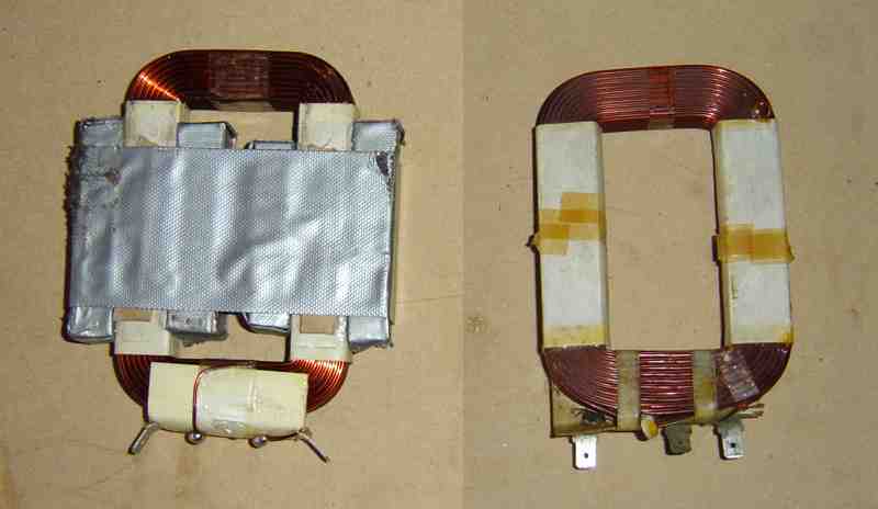

Here are the two coils:

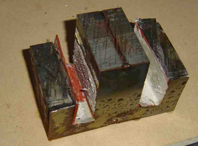

Here is the transformer after I cut off the laminations:
Here are the results of the test:
As you can see, the coil with the laminations produces around 1.8 times the voltage of the equivalent coil without laminations at any given rpm.
If I were to use laminations for this alt, I would look at 3 phase overlapped coils - either 3 per magnet or 3 per pair of magnets (72 or 36 coils total) with say, 5mm (1/5") wide laminations either side of every coil leg going right through the stator.
Is there anyone out there that can tell me why building such a stator would not be a good idea? Would this not allow me to get the most from my magnets? Perhaps the efficiency suffers even though the overall output increases? Perhaps there is something I'm overlooking? Comments welcome!

There is no doubt that using laminations will give you more output for a given amount of magnet material. This is more true for ceramic than for neo.
If you are looking for maximum output at the top end and are not worried about low wind performance that is the way to go.
I don't know of anyone who has tried using bits of lamination in a dual rotor, it certainly has serious mechanical difficulties as the magnets will be trying to pull the cores out. The single rotor arrangement with slotted laminated core can be done quite successfully. for more power you could put 2 back to back with magnets on both sides of the rotor plate.
Once you start introducing iron into the core you start to bring uncertainties into the design with regard to leakage reactance and how the thing reacts under load. This is more of a problem with ceramics and their low flux density as you need more turns.
If you have a leakage reactance greater than the resistance it will tend to flatten out to constant current since the reactance rises with frequency. I think your idea with bits of iron in a dual rotor will be less prone to this problem as the armature reaction  flux will have a hard job finding a leakage path.
It will cog like nothing else but the iron loss should be modest.
Give it a try and let us know how you get on .

Thanks for your input Flux - I appreciate it. With regard to the magnets trying to 'pull the cores out', the cores are being pulled from both sides so would not the forces on the cores cancel out the closer they are to the centre of the magnets? Even if it is not possible to exactly centre the stator, the net force on the cores should be minimal. Assembly of the machine may pose a problem, I haven't yet come up with a way to keep the rotors/stator apart during assembly. As for the cogging, I was hoping that this would be minimised by the fact that in my proposed setup, each magnet covers more than one lamination with only one leaving/entering the influence of the magnet at any one time. This coupled with a slight offset/skew to the magnets and the round shape of the magnets themselves (no abrupt leading edge) should hopefully keep cogging to a minimum.

The forces will be a lot less when centred but still considerable once there is any deviation from centre. You also have the problem of the resin loosing strength at higher temperatures.
With overlapped coils you can bind the ends together to form a self supporting structure to act as a support to the resin and you can make a strong support ring on the outside. If you can find some way to support the laminations you may do it.
As you say assembly will be a nightmare but you only have to face that once.
With only one shot at it cogging may be high although much fiddling with the core placing could reduce it if you tried several, but I don't think it will be a major issue. If you can solve the other problems I think it will fly.
This is a big machine to try an un-proven design, I would be tempted to try a prototype at about 1 kW and see what the problems are.

   My big worry would be the structural integrity of the stator with that much steel in it. As I understand it, coils under load experience a force trying to pull them in the direction of rotation of the magnets; the steel, unless perfectly centred between the magnets, will experience a force at right angles to this.
   I did some single coil tests a while ago using powdered iron (brake machining residue) mixed with the resin in a dual rotor axial flux machine, got about a 20% gain in open volts. Cogging was significant, although as you have mentioned could be overcome with your setup. The big problem, as I saw it, was that the stator wouldn't centre between the magnet rotors, the steel in it wanted to pull one way ot the other, which translated into quite a nasty vibration when the rotors were turning. This may have cancelled out somewhat if I had cast a complete stator this way, but I was sufficiently concerned about possible fatigue failure of the stator, along with eddy current heating, that I didn't pursue it any further.
   This is just my 2 cents worth based on a couple of experiments and a gut feeling, I'm not an engineer and I may have underestimated the strength of fibreglass resin.

yes.. like flux said.
The advantages of the dual rotor is -
  • ease of construction
  • no cogging
  • no iron losses.
The drawback is that it takes a lot more magnet to get the job done.  You'd solve the drawback by doing this, but you'd probably kill our main 3 benifits, vibration and cogging would become a real problem, especially if it were for a wind turbine.  I think before I went putting iron into the stator on one of these I'd look to a single rotor design.. or - start messing with converting existing induction motors which makes for real efficient use of our magnets.  Just my opinion ;=)
