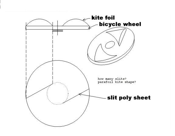

does nayone out there have any links for low speed drag foils- preferably flexible(parafoil kite type).

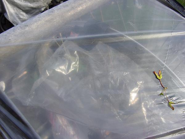

here's a pic

I have been trying to figure out how to get some power out of a short solar chimney. which means among other things- low speed air flow-which means drag type turbines like a savonius. I posted a short solar chimney topic-looking for confirmation of theory more than anything else. with a 3ft dia. x 10ft tall chimney-possibly fed from a pvcpipe/poly sheet greenhouse- I should be able to get somehwere between 5 and 21 rpm at oz.in. torque. not really enough to generate electricity, but anytime the sun was out it would run. I live in NC and getting a steady wind of anykind means being about 65ft above the trees (more than a 100ft tower for a conventional turbine). It would take about a 30ft solar chimney to get the air velocity enough to be able to charge batteries. It also looks like the turbine for a 'short' solar chimney needs to be at the top of the chimney. The max. exit temperature would never get extremely high-so all of it could be plastics. I need more info on how drag kites are designed. this one would function a lot like a savonius rotor. The airflow would actually come from underneath the wheel, but being at the top of the chimney- if there were any wind it would also catch it-like a savonius. a 3x10 chimney should be able to water the greenhouse (relatively low powered pumping of water-ounces per minute....)

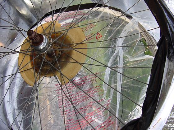

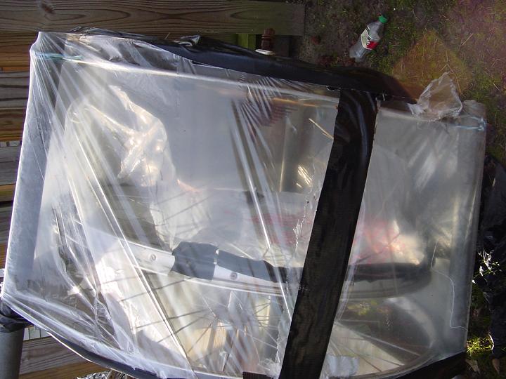

pics of pieces-partially completed-have to add a collector. any comments?

tried to put it up in the wind a few weeks ago-will be another few weeks before I get back to it. with a 'wall' of plastic sheet it just about 'flew' without the sun being out.......(whole idea was wind genny without the wind-just the sun...) ..;-)..

got it partially put up-only place I had to put it was in the shade- will be testing it with a mosquito(kerosene) candle this weekend if the wind and rain don't tear it up in the meantime. no genny on it, just turbine. Will post pics if it spins.

not enough velocity flow in a short one to open the 'parafoil' turbine. I did however stick one on the fence that was lopsided and a recent storm had enough wind in it to make it spin (though erratically). I will be trying one at some point in the future when I can figure a more rigid attachment. the storm winds tore it up pretty good. just an update.
