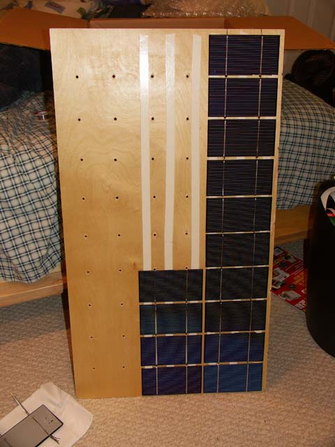

Speaking of the foam support idea, that's what I did for my panel. I used 3 strips of double sided tape for each cell. Seems to work pretty good. I just hope they stay on there with time, which they should, since they are sealed away from the elements. They strips are soft so I imagine when they get pretty hot they will flex with the cell, instead of breaking it.
Some, I believe, are filled with an epoxy type liquid to help with that. I'm not sure how expansion doesnt get them though, since I've never messed with it.
The panels will usually weigh a bit. Mine since it's so big and made of wood, and I used 1/4(I'll have to check for sure) glass, it weighs a crap load. Not something one person could put up, but it's also holding 90 cells.
Here's the finished product. You can look through my files for more pictures.

I finnaly decided on a back plate, it was a tough decision :-)
I ask sombody to go get me a sheet of aluminum, and some aluminum channel to reinforce the back.
he came back with a 50$ sheet of aluminum (EEEEKK)
oops, that would have increased the cost significantally :-( not to meantion having to insulate the conductivity of the thing.
the Aluminum channel was still a good idea for engioneered stability, so i found a nice piece of 2'x4' 1/4" birtch plywood, that looked VERY dry, and aged, and clean, and cheap.
then some enamel white paint to paint it.
i will form joists with the aluminum channel to keep it straight, and depend on the side aluminum channels to finish that task
i couldnt glue to the board, because in 100 years or so the laminate might seperate, and all glues age, i have terrible luck with glue over time, even epoxies, so i am going to have to screw the aluminum joists on, and put the screw heads in the gaps between the cells or somethin.

well i am Slowly getting it together YAAAWWWWN
i think i am going to dubb it ACE , cause there is enough hardware in it to open a store.
i wanted to make sure i could completly dismantle it, alter it, change it, take the cells out, and now its all screwed up :-)
well i coulda used rivets , but this way i can alter any aspect of it.
i still have one BIG problem, and that is how to put the cells themselves in it, so they are SHOCK mounted, but still removable.
or
if i permanent it, i was thinking of putting 5 LINES of silicoln , so convection airflow (within the pannel) can flow up the backside of them.  that would mount them at more places, but still alow the whole thing to expand contract.
I thought about a silicoln Grid, but it would stop air flow in both directions
or
the other person here suggests more of a DOT pattern, one in the center, 4 on the corners.  i think that would be more removable than the lines, but i dont think this is adequite shock mounting.
especially seeings these are reject cells, and are ven more prone to becomming 1/2 cells :-)
