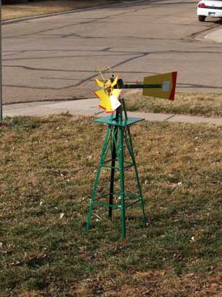

From a distance:

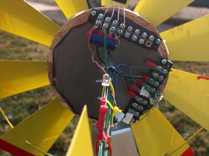

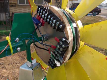

The windmill stands about shoulder height.  Version 0.9 found me making several new guy mistakes, such as not enough windings and not backing my magnets with ferrous materials.  This is version 2.0, which has
  • 7 inch saw blades for ferrous backing
  • 3 phases of windings wound using Ed's method of winding coils
  • A bridge rectifier ($1.99 at Radio Shack
  • A 1000 mf capacitor (also from radio shack
Yesterday, in the stiff wind we have here in Boulder County, my wife commented that she noticed a red firefly in the front yard (she didn't know I'd set it up in the yard).
Here's some closeups.
From the back.
Notice the LED
I got about 5 volts depending on the wind.  My next step is to build a little "LED voltmeter" for lack of a better term.  The more wind, the more lights.  I am also going to wind another stator as I nicked the stator for one of the windings and it does not conduct.  I also am using ceramic magnets (cheap, cheap), and I want to step up a bit.

Congrats on the LED.  So you've got a little voltage there, do you know how much amperage your little mill is putting out.  You might be able to make an array of LED's for a yard light, depending on the current you get with modest winds.  Maybe rig it to charge a 6 volt battery and build a simple circuit with a Cadmium Sulfide light variable resistor and a couple or three fets and a cmos and gate to turn the lights on only at night and only when the battery voltage is above a certain level.  Kind of like the circuitry in a solar yard light.  Just ideas, but maybe they're of use to you.  Rich Hagen

While I don't know what I'm getting out of it, amperage-wise, I doubt it's a lot.  I put 2 LEDs on it, and it seemed to visibly dim both.  LEDs aren't exactly high-amperage devices :-).  I like the circuit that BTH posted, and I believe I'll pinch it.  I'm also going to have to rewind my stator for other reasons.  At that time, I may buy me some real  magnets rather than the little cheesy ones I'm using here.

It looks like it could have eddy current problems.
Does the rear plate rotate with the magnet rotor? (no problem)
Is the rear plate fixed? (problem)
It should be laminated to stop current from flowing around in circles in the back plate.  When it flows around in the back plate, it is not flowing as much in the coils.
I really want to see this bugger do 12 volts!
