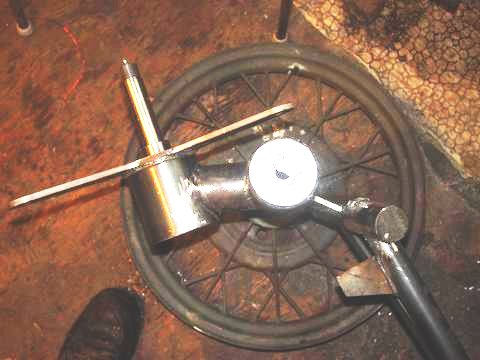

The Yaw bearing is made from a 12" long piece of 2.5" pipe.  The alternator spindle is supported inside a 3" piece of pipe, which is held to the yaw bearing with a short 2" pipe.  The 2" pipe is coped to fit around the yaw bearing for welding on one end, on the other end we simply cut a hole in the 3" pipe and it slips inside.  This makes it easy to set the slight angle (About 4 deg) in the alternator so the blade tips will clear the tower.  Pictured above I'm cutting the hole in the pipe that supports the alternator.
Above are the two pipes I was talking about before.  The larger one will have the wheel spindle right through the center of it, supported on one end by a 3" OD and 1.25" ID 'washer' (cut from 1/4" steel), and on the other end by the stator bracket.  The larger 3" dia pipe is cut 3 5/8" long, and the short pipe which attaches it to the yaw bearing is cut 3 1/2" long.
Pictured above are the pipes that will make up th tail pivot.  The smaller one which is attached to the machine is 1" pipe, cut 9" long, the larger one will slip over that, and pivot with the tail.  It's 1.25" pipe, also cut 9" long.  The notch is pretty easy to cutout with a hacksaw or bandsaw...  I used the milling machine.  I cut almost half way into the pipe, and the cutout is 4 1/2" long.  (actually this one was a bit shorter than 9" long, but most of them are 9" long and we notch out half of that)

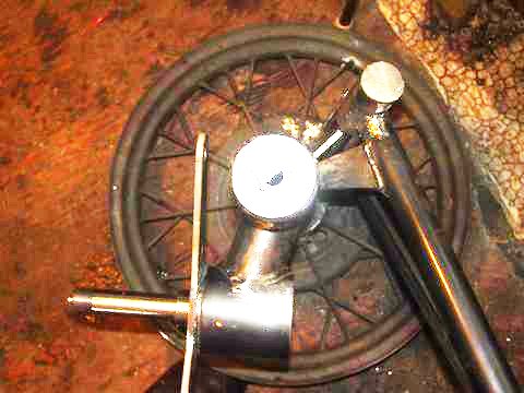

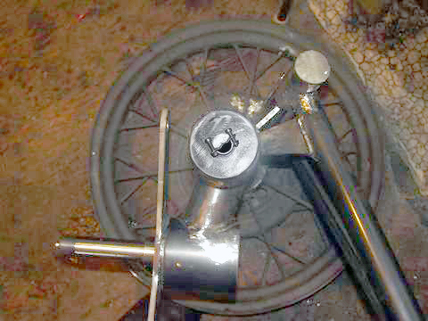

You can see the small 'stop' (made from 1/4" steel) thats welded to the tail.  Rather than depending on the notch in the tail pivot to keep the tail out of the blades, I'm just welding this stop on now.  I think it's stronger, and easier - it allows us less precision in milling (or cutting) out the notch in the tail bearing.
There is a picture of how the 'stop' will hit the yaw bearing in the fully furled position.  Also notice the wire clamp, which is threaded into the yaw bearing cap.  This will clamp the line that runs through the center of the tower.

Ouch!  It hurts just THINKING about the leverage at that tail stop.
I'd move it farther out and have it fetch up against the back of the main shaft hub.  (Even if it were to be left hitting the yaw bearing I'd change the shape so it sits as far from its pivot out on the tail boom as the distance between the yaw bearing and tail bearing.)
The further out, the less stress on the tail bearing, the base of the tail boom, and the base-of-boom weld, when it strikes during a gust.
Re: Yesterdays madness (3.00 / 0) (#7)
by DanB on Tue Mar 15, 2005 at 10:55:44 AM MST
yes, I've thought about moving it there...  though it would have to be much longer, so at the tail there would still be quite a leverage issue.
I guess my thinking is that - as it is, it's quite a lot stronger with quite a lot less leverage than it was when I was relying on the notch in the tail pivot to stop things.  And I believe that worked fine...  I dont think relying on the notch ever failed, though Scotts did get bent once when his tail (rooster feet) caught his blades and the whole tail was yanked off the pivot.
but yes, perhaps that should be stronger, I tend to think its stronger than the plan of just using the 'notch' though - which has worked fine on several machines so far...
