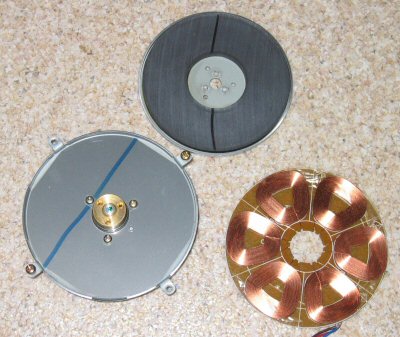

did you wind those coils ?
That looks like a Floppy drive for the generator ?
Time to build a 2nd prop then huh ?

Re: Not quite a maple blade (3.00 / 0) (#3)
by XRay on Wed Mar 16, 2005 at 01:11:42 AM MST
He! Wooferhound, yes it's a 5¼-inch floppy disk drive. The coils are usable for other tiny projects, but the bearings and magnet are just too weak.
I think I keep this setup as is, and move on to a Hugh Piggots type of mill for some real electrical power.

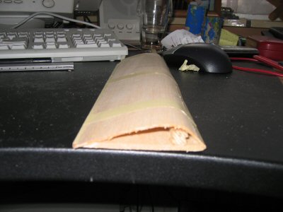

Re: Not quite a maple blade (3.00 / 0) (#5)
by rotornuts on Wed Mar 16, 2005 at 03:38:37 AM MST
I'm not convinced yet that the effect you described is entirely due to the drag of the one blade quite as much as it is a balance issue. The effect you've described will exist but I don't think it's insurmountable. If you examine a maple seed you'll see that the counterbalance is also providing some lift or drag. I continue to work on the second generation maple blade but progress is slow because of what I learned on the first one. I'm now trying to stay as close to mother natures design as I can although I'm not sure what the effect will be. The big issue here is to ensure you have balance on all three axis - top to bottom, side to side and front to back across the axis for all three. A two or more bladed rotor generally only needs to be balanced on one axis so it's a different way of thinking about balance.
By looking at your photos I'd say your blade and counterbalances are out of alignment. the blade needs to come towards the front or the counterbalances towards the back.
If you were to put an eye hook in the dowel at the end of the blade and hang the blade assembly, without the alternator, off a string would it hang straight up and down front to back? How about side to side? Another thing, you have more blade(mass) on the trailing edge than on the leading edge, you need to mount the spar off center towards the leading edge.
I've been hammering away at this for a while now and I think there's a few more nuts to be cracked yet. Remember, when you change one axis it may effect the other two.
I applaud your willingness to have a go at this and would encourage you to continue. I'm working on a ball socket hub that I can lock and unlock to move mass around, It will leave pitch at the mercy of balance but I have to start somewhere.
nuts.
Re: Not quite a maple blade (3.00 / 0) (#6)
by XRay on Wed Mar 16, 2005 at 01:44:16 PM MST
rotornuts,
I admirer your work, the maple seed replica looks real good. The post of the second one I mist, looks good to.
Ok, in my post a wrote about lift and mainly about the tip lift which becomes greatest at higher speed. You can test that wobbly movement real simple, hold the axle in one hand and push on the tip with your other hand which represent the drag of the wind, can you feel the lever effect?
About the balance, you are absolute right. I only balanced it on one axle.
Maybe when I have some time, I'll balance it on all three axis.

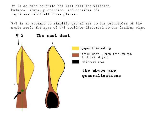

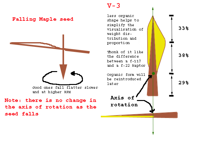

illustration (3.00 / 0) (#16)
by rotornuts on Thu Mar 17, 2005 at 02:48:25 PM MST
OK Xray now your on to why I'm into this. I firmly believe after much nashing of teeth over how to design a windmill that will maximize low wind speed performance without killing higher wind performance this is what I came up with and the maple seed as a model was norms inspiration and it makes sense.
Below is an illustration of how a maple seed falls. It autorotates to the ground like a helicopter would. the better ones fall flatter and rotate faster and these are the ones I'm modeling. The man(or woman?) who designed the maple seed is much smarter than I so it's been a slow road of discovery but as norm has pointed out all things are pointing towards not meddling too much with the proportions of the seed. The below illustration also has a representation of what my next(V-3) blade will look like. It's less organic looking but more closely follows the proportion of the "best fliers". The seed you posted is I think a sycamore which is a maple but I think the more common maple such as a norway maple or a sugar maple is best.
Again you'll note the less "organic" shape of the next version but I after two tries I think I'm fooling myself to think making it look exactly like a maple seed will make it one. The Idea now is to mimic the maples wieght distribution, cord distribution and thickness distribution and be rid of my attempts at improving the blade profile. So V-3 will have a thin airfoil just like the maple and the counterbalance will mimic the maples dispite the fact that the thickness distribution seems backwards from an aerodynamic point of view.
The spar is designed to do most of the work of distibuting the wieght.
Re: illustration (3.00 / 0) (#17)
by XRay on Thu Mar 17, 2005 at 05:27:08 PM MST
V-3, sounds good. :)
Just a small question (A have to get up early today)
What purpose has the thin part (small yellow part) at the leading edge of the wing?
I cant find it on a maple seed, or is it to simplify your model?
O yes, a other question, because I have no real maple seed to look at right now, is a maple seed wing a symmetrical airfoil?
Thumbs up for the V-3 and go easy on your teeth, you'll need them :))

Re: comparison (3.00 / 0) (#18)
by rotornuts on Fri Mar 18, 2005 at 04:29:53 AM MST
Yes, the yellow portion of the blade ahead of the spar is a consiquence of my attempt to simplify the construction. I could move the spar into this area but I'm afraid of complicating things at this point. I've build two complicated versions and I don't want to do it again without using a method. At this point all my work has been educated guesses and I'd like to start applying some design principles, so I'll pull back to a simple version and start working towards a more faithfull representation of the maple seed as I achieve successes but using repeatable and quantifiable technique.
Below is an illustration comparing a maple seed to my proposed next version. The yellow portion is paper thin and the airfoil is like a birds wing trailing off the top(or back of the illustration)of the bony structure that I'm calling the spar.

Exactly. I need to learn why a maple seed does what it does. I already know that it does it and just copying it will tell me very little. The other thing is that I've actually tried twice now to copy the organic form and it's a stab in the dark and really hard!!!. A methodology is needed. I don't really believe a scaling unit would do a very good job.
Re: comparison (3.00 / 0) (#24)
by XRay on Mon Mar 21, 2005 at 05:51:15 AM MST
Rorornuts,
Sorry, I used youre "The real deal" part of your drawing.
Yesterday I found some maple seeds and selected the best, the best gliders were the ones with the biggest flap and straight wing. Ok they were not in the best shape, spring is not a good season to hunt for seeds.
Anyway, I think a have found a reason for flap part of a maple seed, namely its to control the angle of attack.
During the fall to the ground, the maple seeds RPM increases and the angle of attach gets smaller, maybe almost zero degree (cant see that, just assuming).
fig.1fig.2
Also the maple wing has barely an airfoil shape [fig.2] but it is symmetrical.
My question is: am I correct about the flap?
And if your coal is to get as close as possible to a maple seed wing, why is your wing not symmetrical? See your first picture, "bottom axis of rotation"?
Greetings,
Ray
You dont know how little you know.
till you know enought to know that you still know nothing
Re: comparison (3.00 / 0) (#25)
by rotornuts on Tue Mar 22, 2005 at 04:22:44 AM MST
Good observations. There are indeed what appear to be flaps. The seeds that have the tip flap leading into the direction of desent and the wing flap trailing the direction of desent seem to fly the best(Highest rpm and slowest desent, almost horizontal). Intestingly the seeds don't always fly with the same side up so the same seed can sometimes fly "upside down". I choose which is right side up by flight characteristics.
The more I look the more I think your right about them being symetrical. I at first thought they were cambered by default because I thought the "skin" trailed off the back of the spar but I looked my pile over again and I don't think that's true anymore. I didn't pay very close attention to this at first because I, in my infinite wisdom, was going to produce a "better blade".
You caught me on the lower axis of rotation diagram. I goofed it up and didn't bother fixing it. It should show the blade and the spar centered but I didn't think anyone would notice.
Now that you've played with the seeds don't you find it fascinating how these products of nature have so many favorable characteristics that man has been working years to discover. One of my favorites is the ogee shape that many of them have towards the tips. I discovered some research about a month ago that was done recently that suggests the ogee shape is the best trailing edge tip shape to reduce tip drag and noise. they also suggested that a serrated trailing edge may reduce overal drag and stall propagation. Hmm.
I'm trying to figure the best way to pull this off but I have to admit at this point the situation is pretty fluid as I make new discoveries and come up with new ideas every day.
One last thing. The "spar" parts in my diagrams are somewhat misleading as they should indeed have a thickness that more closely resembles what you have drawn. I wanted to show what I though might be the easiest way "build in" the proper wieght distribution so I left them exagerated. A long cone will be perfectly balanced side to side and front to back so all you need to do is find center of rotation, but because we are adding a blade to the cone and we want to flatten the fat end somewhat and give it something of a profile, the cone will need to be led in one direction or the other to compensate.
Lots to think about yet, but I think I'm heading in the right direction. Please understand though(I'm sure you do)that it's hard to explain every detail. I'm glad someone is taking an interest in this.
I want to retain what seems to be the averaged proportions and distributions of the maple seed. As both you and I have discovered balance is the big issue here so I'm making compromises to solve that problem first. As I learn more I'll re-introduce some of the favorable charactistics that could make it harder to balance.
