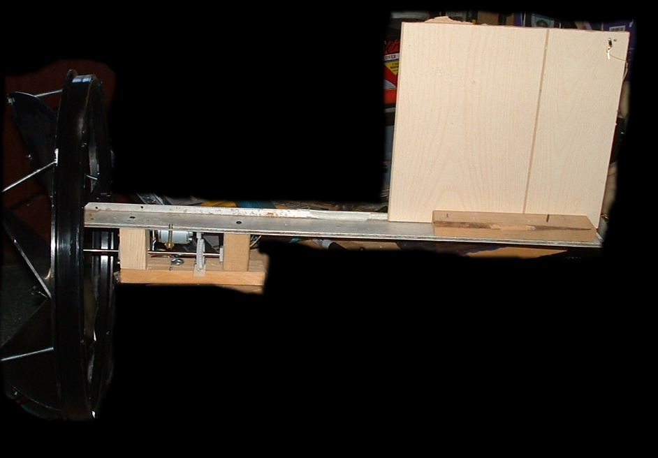

More testing and modifications. Now that I have the double zubwoofer geared 2 to 1 there isn't any power under 8 mph. The good news is that anything over 10mph has been charging all the 12v items I can find. Even charged a dead makita battery. Have seen over 40v out of it a couple times with no load.
Here is the new chart.
I have also built another mill with my daughter. Someone gave me a broken HP printer and I looked it up on fixyourownprinter.com and decided it was a lost cause. Lots of parts, shafts, motors, gears led's. We had a good time tearing our broken electronic equiptment apart and turning what we could into another mill. No photos yet but it is definatly worth a good laugh. We used the sputnic on that one for now.

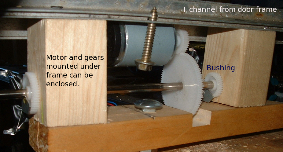

We arent planning on getting any power out of the printer mill, just enough power to light 6 led's. We used some of the gears to drive the motor about 3 to 1. I don't expect it to hold up too long but it is a fun little throw it together project.

I agree. Sputnic would be great at about 4' in diameter. Believe me I have been looking for large round sturdy plastic objects. Here is the joke I have put sputnic on for now.
It is mounted on part of an old aluminum door frame with a paneling tail.
The printer motor has a small nylon gear from the scanner paper feed. The shaft was from the printer paper feed and the large gear was from somewhere in the printer.  The 2 bushings were double gears. They are countersunk into the wood blocks and held in with some speaker clips out of an old boombox.
Darn, I have to redo that photo. Anyway, sputnic has a 7/8" hole so I used the rubber rollers that were on the shaft and mounted it with a 2 screw romex connector. It has 6 leds on it in various locations. Now to get it out in the wind, or as it goes, outside waiting for wind for the next few days.
I'll get a better photo of the gear drive today.
