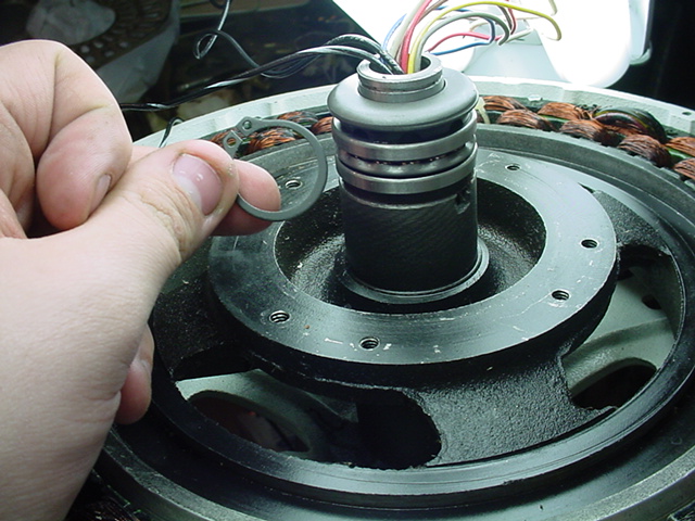

I picked up the big one today.
It was still at the scrap metal place. $5 so worth a shot.
Here are the specs.
120 vac, 2.3 amps, 28 coils, 11.4 ohms dc, outside stator measures 11.5", rotor measures 9", rotor and lamination 1" thick, rpm 225.
I pluged it in. It works good, very slow. Many thought of what to do with it now?
I was thinking if it would act like other ac induction motor when spun 10% above the rated rpm with caps accross the ac wirees will this one make power. AC induction generater? Would be easy to spin this with a blade in the wind. Then use a transformer to reduce the voltage and increase the amps?
Or machine the armature down and add magnets? This is difreant than the normal small ceiling fan motors. The small one have there stator in the center. This one is like
a normal motor.
24 coils of very small wire so could rewire it with bigger wire or perelell the stock small wire coils?
How could I arange magnets so this could be 3 phase? I'll play with the stock wires first the maybe make changes later?

by ghurd on Thu Mar 03, 2005 at 07:08:09 AM MST
What rotates?
It kind of looks like the brown part in the center rotates, and the outer coils are stationary?
This is different and a lot bigger than any I had, all with the fixed coils in the center, and the outer areas rotating.

by Jerry on Thu Mar 03, 2005 at 09:09:18 AM MST
Thanks for all the input guys. I think I'll just go strait to to the magnets.
I'm thinking small ceramics for now. Cause I have a bunch. Also thinking of building another rotor for NEOs. Yes the coils on the outside are stationary.
This unit should make high voltage at low rpm. I've done a test with a 120 volt 6 pole conversion. It makes high voltage. Enough to operate a computer power supply.
Neat thing about the puter suplly is it very regulated and will operate from 80 to 240 volts at just a couple amps in. This might make a low amperage regulated 12 voltage source for small needs?
I'm going to cut the ceramics so they will sit at a scewed angle.
Hey Dan you should try a few things on yours and we can compair notes?
The brand is Montgomery Ward. The maker is Evergo Industrial Enterprise LTD of Hong Kong. Model E-8 42228.
This unit gives me ideas for building something simular from scratch.
Time to get busy and see what this thing can do?

by Jerry on Fri Mar 04, 2005 at 10:01:54 AM MST
Hi Olvvlo.
Your right about the 3 phase. Most of my (95%) conversions have been single phase or actuly 2 phase. This is the result of including start windings as well as run windings.
I'll take it apart and check on the squewing? I have the 1 7/8" by 7/8" by 3/8" ceramics. I'll cut the lingth to match the the staotor thickness. Squewing of the magnets woul be easy at this point. I'd just cut them at an angle.
I'd thought of pulse charging with caps with this unit also. First thing though is to put the magnets in and go from there.
I was very suprized to see this much intrest in this motor? Yes it doies look like the F&P inside out.
I think there is much merrit with large diameter, laminated stators, many poles and magnets.
with these arangement its easy to do sires, perelell or combination of both to get the voltage, amperage or cutin speed you want.
I'm not afraid of small wire this way. Many coils of small wire in perelell can do the same work as large wire coils in sires. Same effect when using a large # of small diodes and small doides are cheap.
Theres just no end. It seems the more you expiriment the more posabilitys open up.

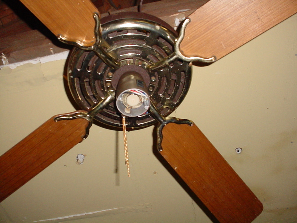

by mrfanman2u on Sun Jun 19, 2005 at 11:37:24 PM MST
well, first of all let me say this.   You ruined a ceiling fan valued at close to $1,000 but other than THAT i like your idea, lol.  We collectors call it a "evergo banana fan" very rare fan indeed only about 500 or so known for the time being.
I know this is wierd, but i actually collect ceiling fans as a hobby, i have close to 80 of them including two identical ones to the one you have jerry. i also have several of those stators you speak of( the 28 pole)
I do foresee a small problem that i do not know if you have addressed yet.   THis is a shaded pole motor. To get the efficency correct to try to run it on two phase( or whatever you're doing with it) the shading coils must be removed. the shading coils' purpose is to give the motor the kick to start and run in one direction.
Here is a picture of one of my fans.
and p.s. these fans( the evergo version are very rare) however, the Hunter version of the fan ( the 3 speed reversible model) is very common, and you can ususally pick them up fairly cheaply.
Also, if you still have the blades (paddles) i would be interested in them, as well as in the old housing to it.

by Jerry on Fri Mar 04, 2005 at 08:18:39 PM MST
I recently did a post on a light dimmer as a motor speed control. This big ceiling fan has what apears to be the exact control part for part.
I pulled it apart today and its not squewed. The slots are straight up and down.
The laminations are 3/4" tall. The pole width between slots is exactly 7/8". The same as my magnets.
It dosn't look like the original rotor will work for these magent. Its to thin. After machining for the magnets there wouldn't be any rotor left. I will build a new rotor out of solid steel. I will squew the magnets. I'm not sure at what angle I should cut the magnets however? How much of the neiborhing slots they should cover?

by Jerry on Sat Mar 05, 2005 at 09:26:03 PM MST
Your sounds like the arangement they use on the small motorts?
The same scrap yard has a stack of steel disc. Round but ruff cut. They lookt to be about 9" dia. .25" thick.
I'll stop by moday and pick up a few. I can true them up on the lathe.
I'll bolt 3 together and maichine them to take the original bearings. These bearing spin so free I can just blow on the rotor and it starts to turn.
I'll get enough discs so I can make a rotor with ceramics and one with some of EDs 1"X1/2"X1/8" NEOs.
I'll try the small stock wire first and then maybe rewind witrh the big stuff also if I can't make something usfull with the small wire?
Next trick will be how to atach blades to this thing? OH and some type yaw bearing?
